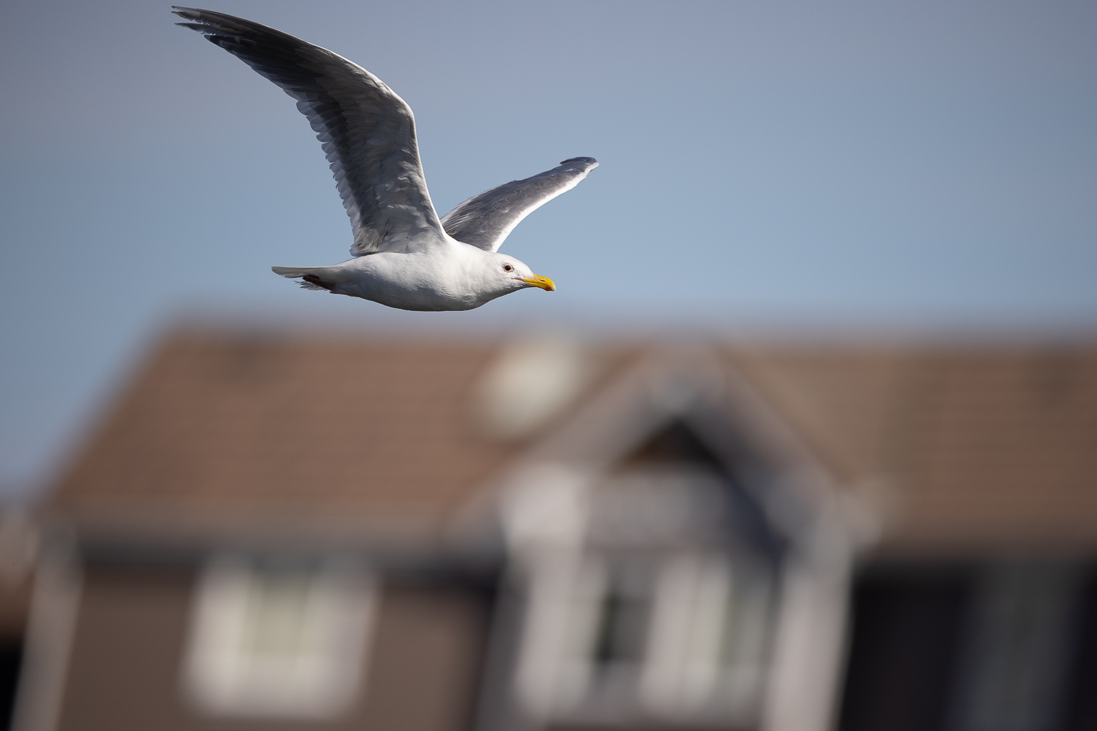

In common use for BIF it’s extremely unusual to see any rolling shutter with the R5 except when shooting small fast birds. In my experience it usually manifests as banding in the wingtips such as this example at 200%

Chimping
p.2 #8 · Rolling shutter examples at 20fps? R5/R6
I have seen that ES effect before too while photography small fast birds. Thankfully, it's not too difficult to fix in post.
Again, I have to qualify my comments, it is extremely unusual to encounter rolling shutter with the R5 for wildlife even while panning. I've had to dig through nearly ten thousand images to find a couple of examples and they were all in smaller, fast birds. At normal magnification, it isn't too prominent and one has to search for it. Obviously, with cropping and pixel peeping it is evident. The sports issue is entirely different and I never shot in ES with sports.
Out of curiosity, what is your favorite approach to fixing it other than blur or careful retouch?
I understand what you're saying, and I agree. It's extremely unusual to encounter the rolling shutter effect with the R5. I've only seen it in my photos a handful of times, and each time I've been able to make reasonable edits to fix any issues.
There is no way around "fixing it" other than blurring or careful retouching, unfortunately, when it does occur.
As to my editing method: I create duplicate layers in photoshop, and add a gaussian blur to the top layer of the image. Then I create and invert a layer mask and "paint" the blur in around the wing tips using my Wacom tablet. I find this method doesn't take long or create much extra work, especially when using my pen tablet. I can get quite a natural look from this method, too.
