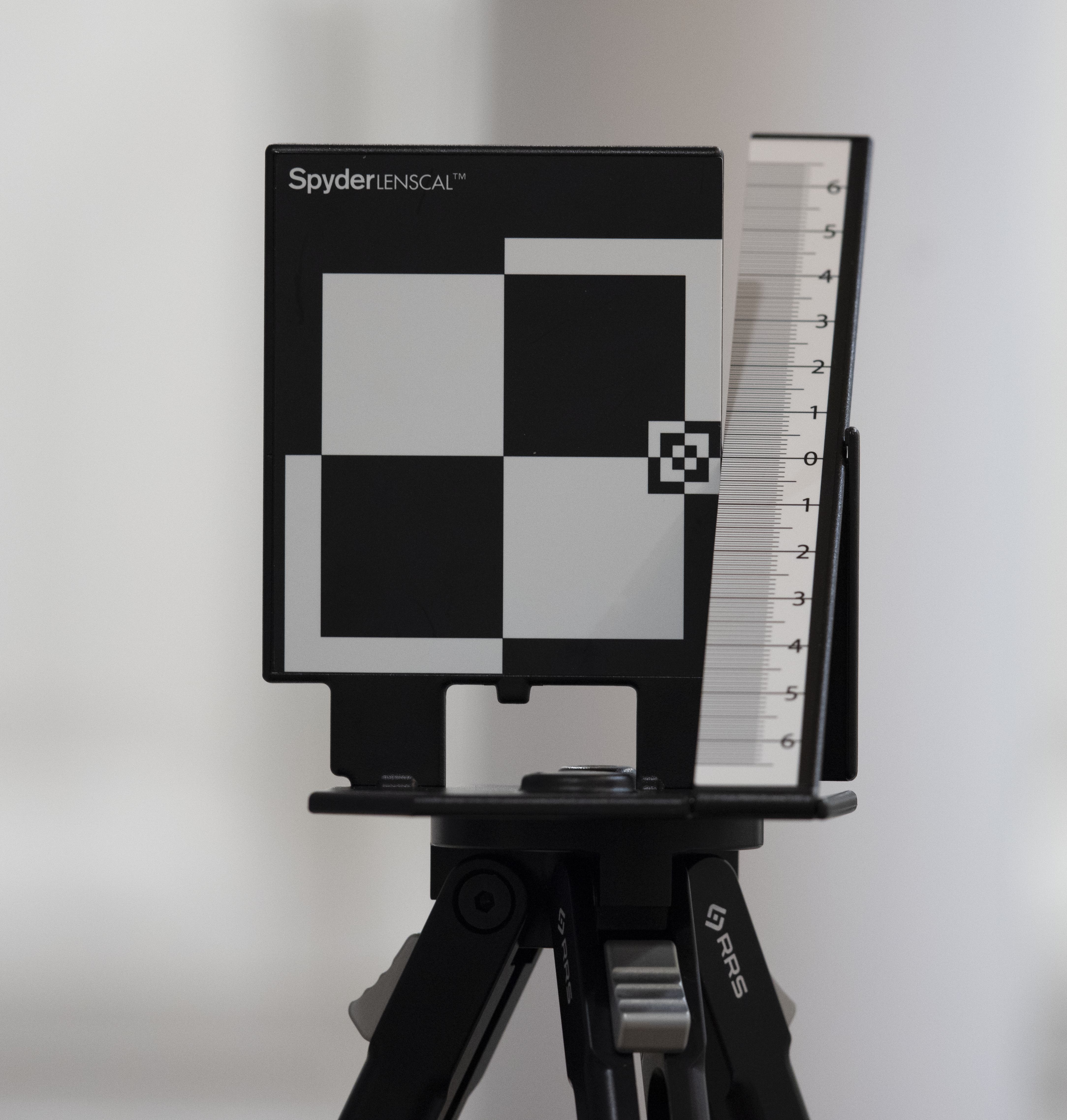

I have had good results with my R5, however I noticed that I was missing shots with my 600 f/4 II. I set up a target and shot some test shots with the 600, my 400 DO II, and the R100-500. I shot 4 shots each at ISO 400, 800, 1600 and 3200. In all cases using the 600, the R5 was focusing in front of the target by at least 6" and maybe more as the target only is marked for 6".
I considered that the problem might be the lens and I shot the exact same sequence with my 5Dsr with excellent results. I shot the same sequence with the 400 on both cameras and also with the R 100-500. All lenses were excellent - except the 600.
In trying to resolve the issue I am reading that the R5 doesn't have microfocus adjustment because of the way its sensor focuses. So if anyone can enlighten me on this I would be grateful. Additionally the camera locked up on me today and I was only able to "reboot" by removing and re-installing the battery - not sure if that has any significance. I have installed firmware 1.2 without any issues.
Thank you for any help or insight on this.
Cheers!
Frank

Frank Kearney
p.1 #6 · R5 Front focusing significantly - is there no microadjustment?
I went back to double check, and all shots "except" the 600 had the focus point displaying on the target. I will redo the series again tomorrow and see what might be happening, because in all cases I focused first, got the beep and the green square and took the shot using a 2 second time delay. When I looked at them in DPP, there is no red square anywhere just a grid of a hundred or so squares, but none in red. It is now looking more like a problem with the way the lens was set up, which would be great, because I can fix operator error by myself.
I will redo and report back. Thank you for the insight - it really helps to have another perspective.
Frank

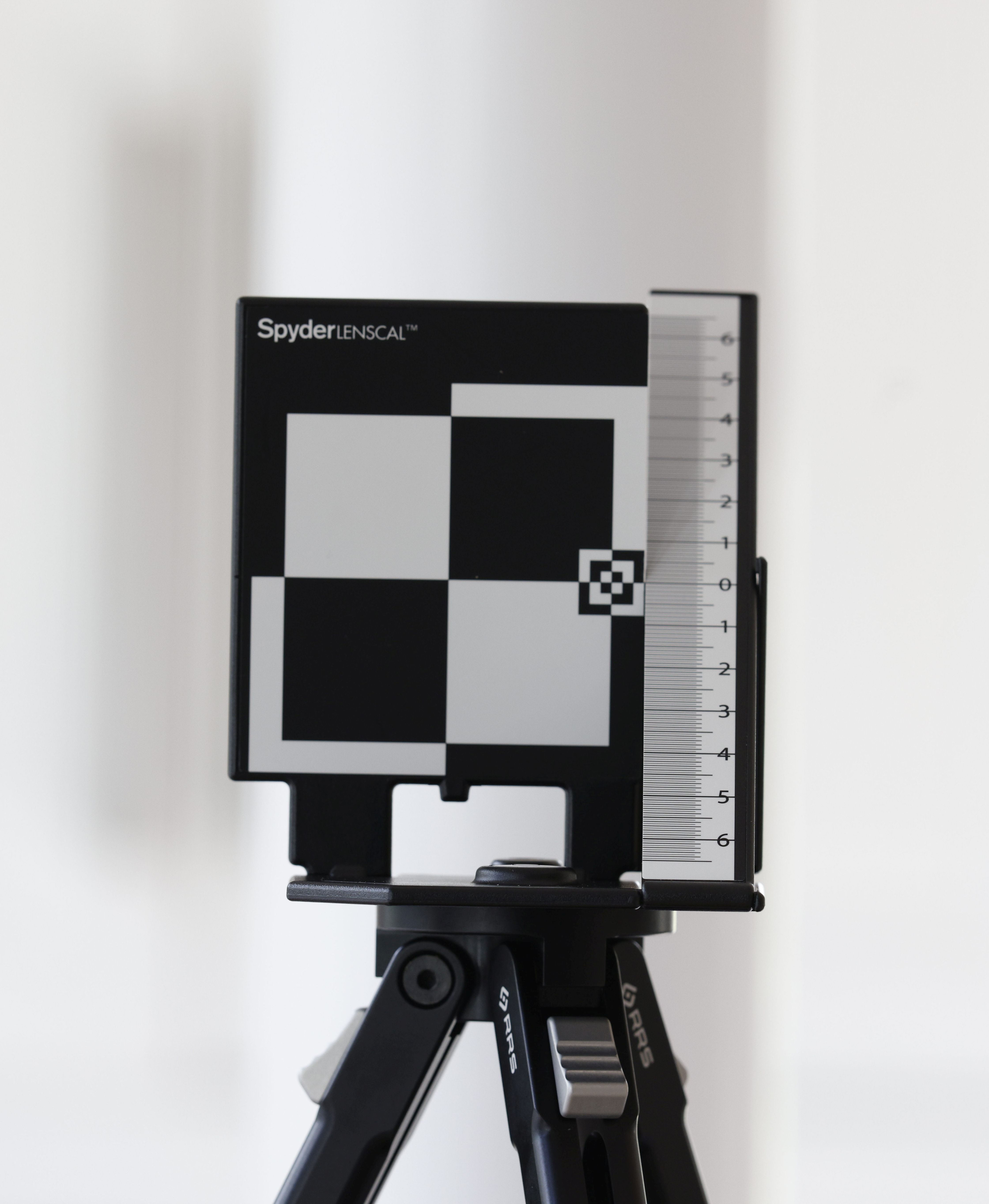

Frank Kearney
p.1 #14 · R5 Front focusing significantly - is there no microadjustment?
I am very happy to report that you were exactly right. I don't know how it got into zone autofocus, but clearly operator error - probably pushing buttons when I shouldn't have been or at least not until I was certain what I was doing. As I am sure you know, this is a very complex camera, and one thing changed affects others. But I reset to my original autofocus and this was the first shot. This will also explain why I had such a difficult time shooting yesterday with everything out by just a little. It is apparent now that the zone autofocus was grabbing the nearest part of the bird, and with f/4 it was "almost" in focus. The shots using eye focus were excellent.
Thank you again for helping me think this through.
It's also the end of the year, and let's all hope for good things to happen next year. As the saying goes, "it has to get better because it couldn't get any worse". And the corollary to that is "oh yes it can!"
Happy New Year to my FM friends and again, thank you.
Frank
