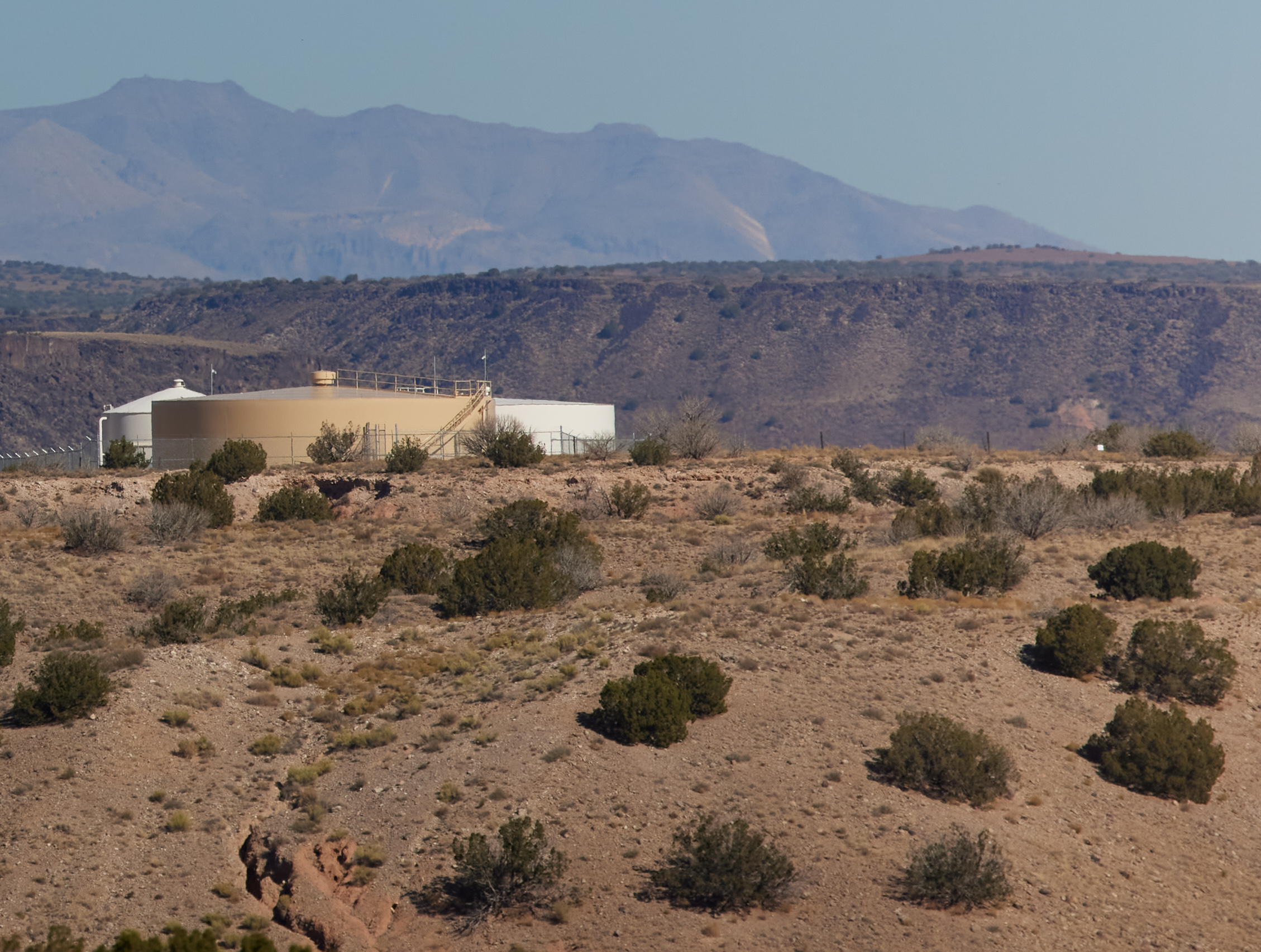

highdesertmesa wrote:
UPDATE:
– Today's test: water storage tanks about two miles away
– 70-200 wide open and stopped down to about f5
– Same tanks placed in bottom left and right corners by moving the frame for each shot (to rule out atmospheric effects, distance, and/or subject detail issues)
RESULTS:
When shot at f5, both corners are sharp regardless of which corner I focused on
When shot at f2.8, only the corner focused on was perfectly sharp.
The only conclusion I can come to is IBIS may not be able to perfectly align the sensor for infinity focus, so when shot wide open, IBIS will prioritize the alignment
...Show more

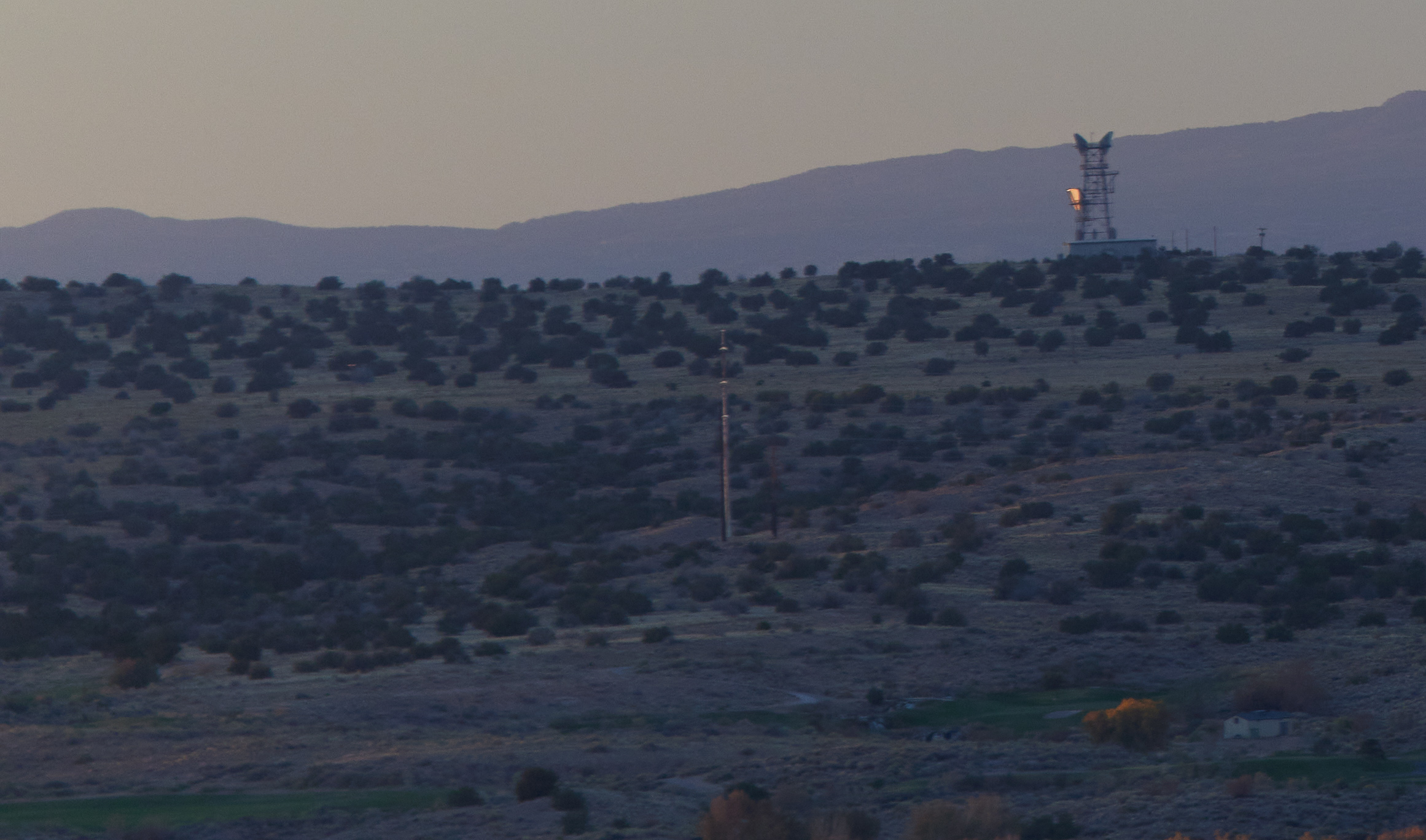

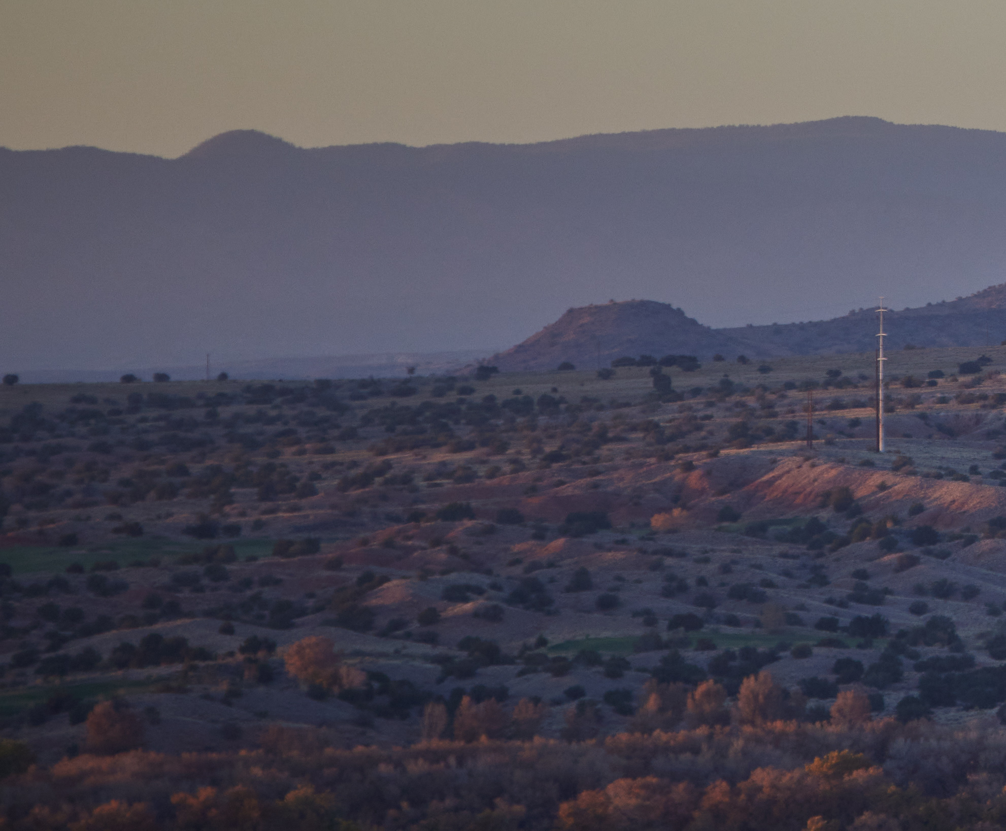

Thought I should show the corner crops from the no-filter shots. This is a pretty wide aperture shot at f/3.5, but both corners still look very sharp.
Filter removed – bottom left corner 1:1 screenshot
Filter removed – bottom right corner 1:1 screenshot
Full frame for reference for the crop areas

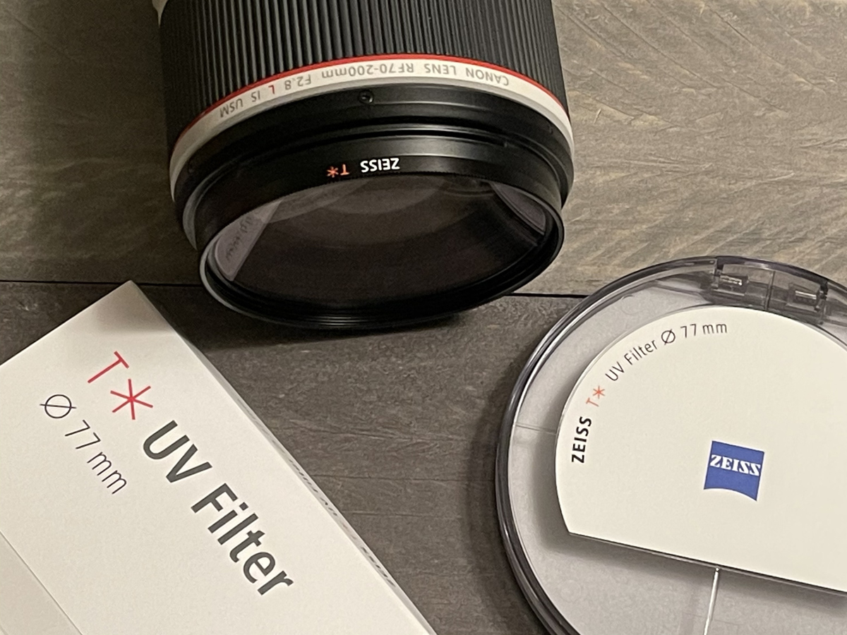

UPDATE:
Turns out my OCD just can't handle not having a clear filter on my RF 70-200 2.8. Every time I walk out the door in the high altitude desert here, I have a good chance of eating a gust of blowing dust/dirt/grit from out of the blue. And during the months of monsoon season, add mist/rain to the equation.
Got a Zeiss T* UV to see if the results are any better than the B+W Clear Nano filter that was reducing sharpness at infinity under 1:1/2:1 magnification. Will test it out tomorrow in the daylight.

Tested this morning. Zero detectable IQ loss using the Zeiss T* versus no filter @ infinity and high magnification review. No more B+W filters for me at 45+ mp.
