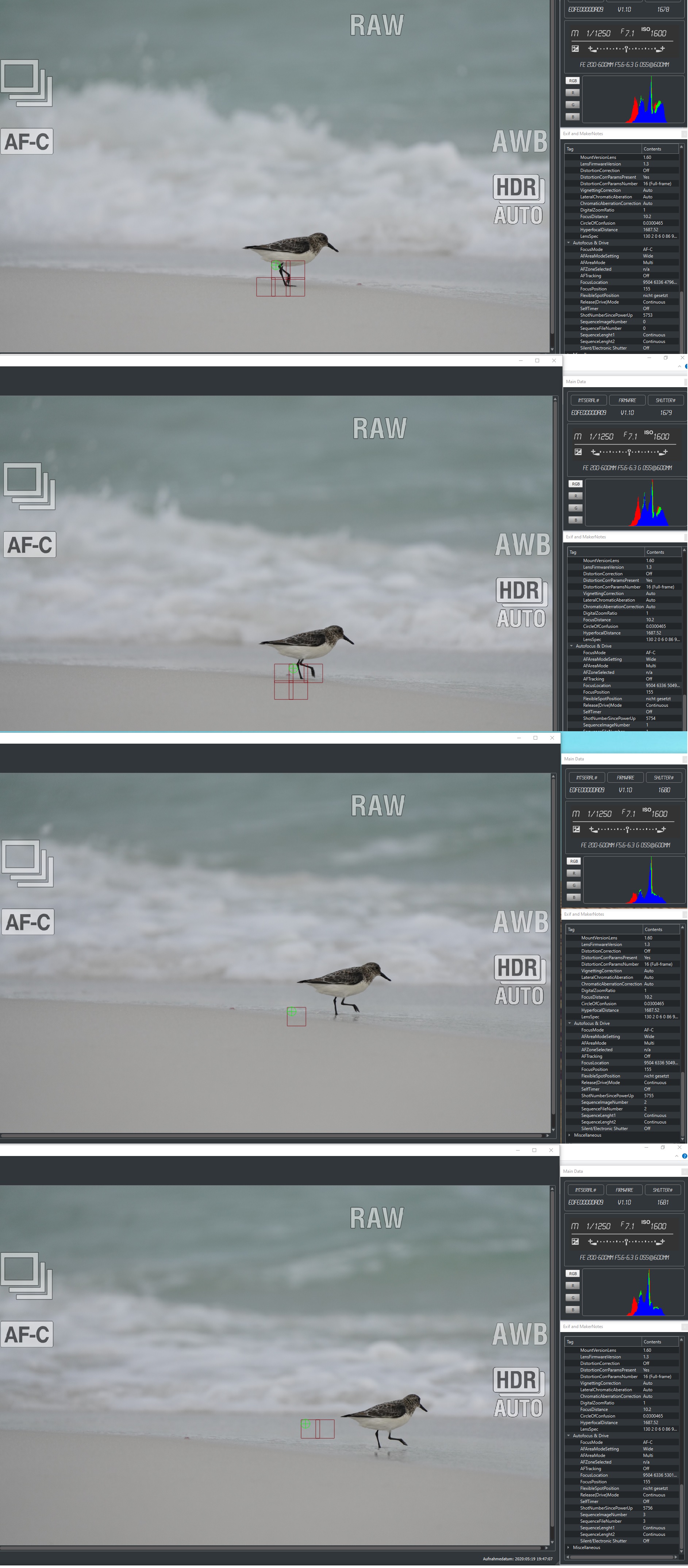

armd
p.9 #9 · Giving up on a7RIV and 200-600 :-(
Bryan, generally it is assumed that the lens will be more accurate when it doesn't have to "rack" the full focus distance. Thus if one were shooting objects > 10m then one should select 10m - inf.
Back to the conversation regarding the AF issues with the a7riv + 200-600 combination. As Mr. James observed in his video, the AF points don't seem to correlate with what the photographer is seeing in the EVF. It's as though there is some sort of disconnect between what is being displayed and what the camera is selecting for AF.
Whereas the other afternoon, the combination seemed to be working fine, another trip to the beach following a sandpiper in the surf was simply exasperating. Working in "wide", the small green boxes were lighting up and following the sandpiper as it was slowly moving near the surf. One would expect that all of the images would be in "adequate" focus. Upon review in camera, the af points were no where near the subject in 50% of this sequence. The first two grabbed the sandpiper's legs and the other two were grabbing space. This was confirmed when viewed in A7info and I've included the four image sequence below...
May 25, 2020 at 11:30 AM

armd
p.9 #11 · Giving up on a7RIV and 200-600 :-(
There are several ways to determine the a7riv AF point. First, if you look at the image in camera and press on the 100% mag it supposedly magnifies to the af point. This correlates with the program that I used for the images, A7info written by Soens (www.soens.de/download). If you download it, please send a few $ his way. Other programs will accomplish this as well.
May 25, 2020 at 01:48 PM
