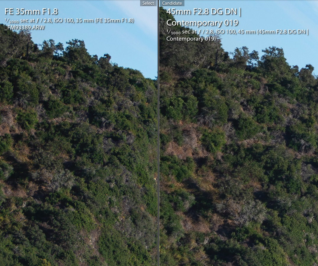

  1. About the lens

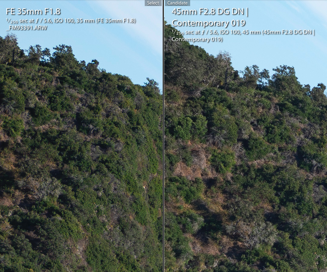

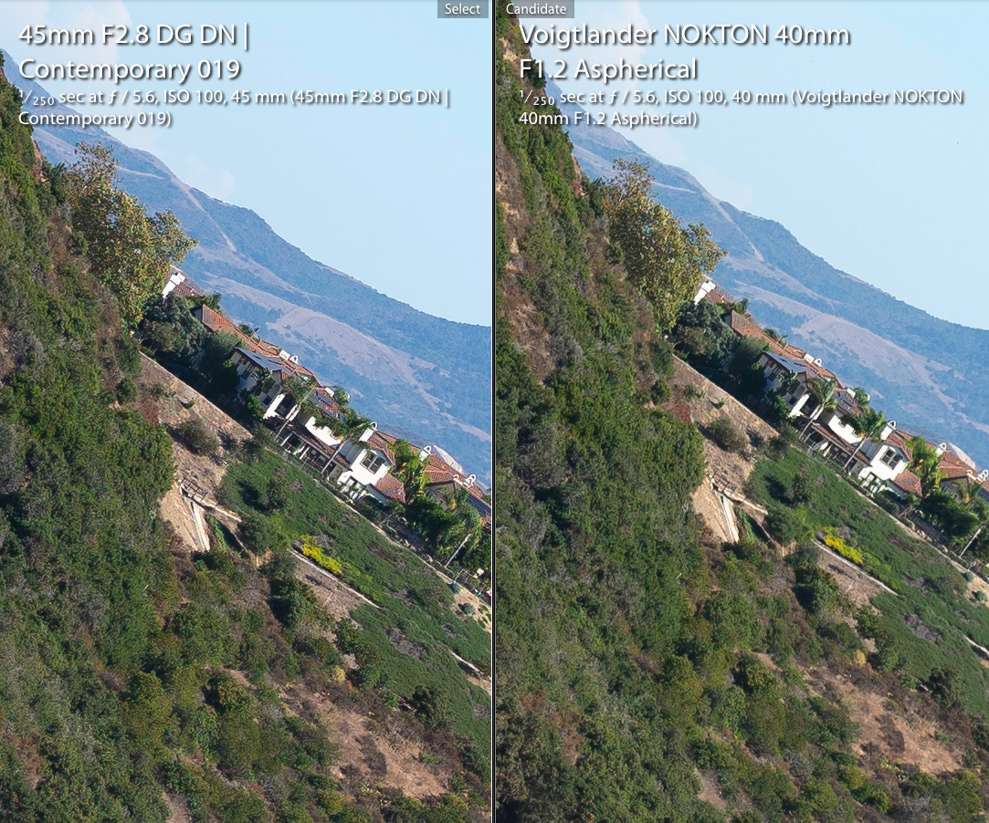

  2. Infinity Performance

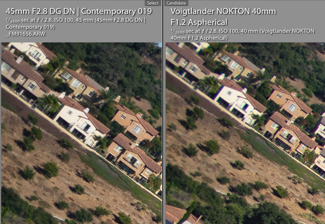

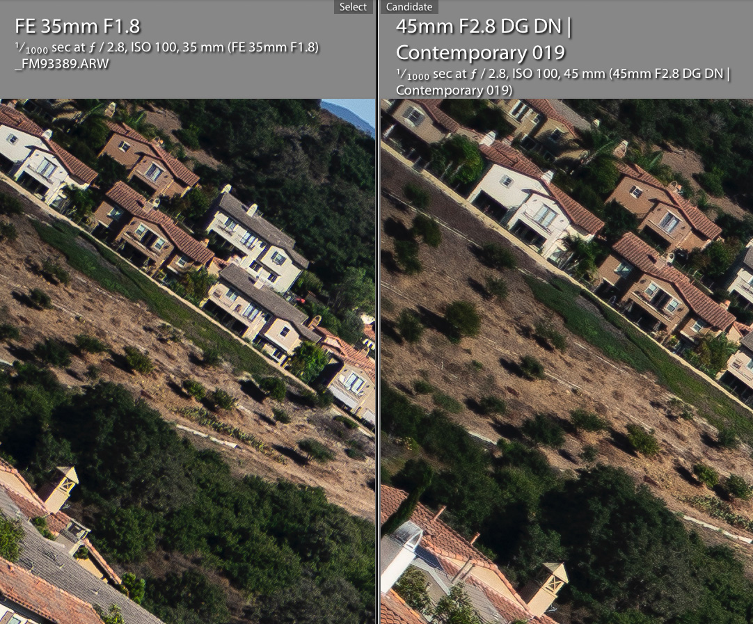

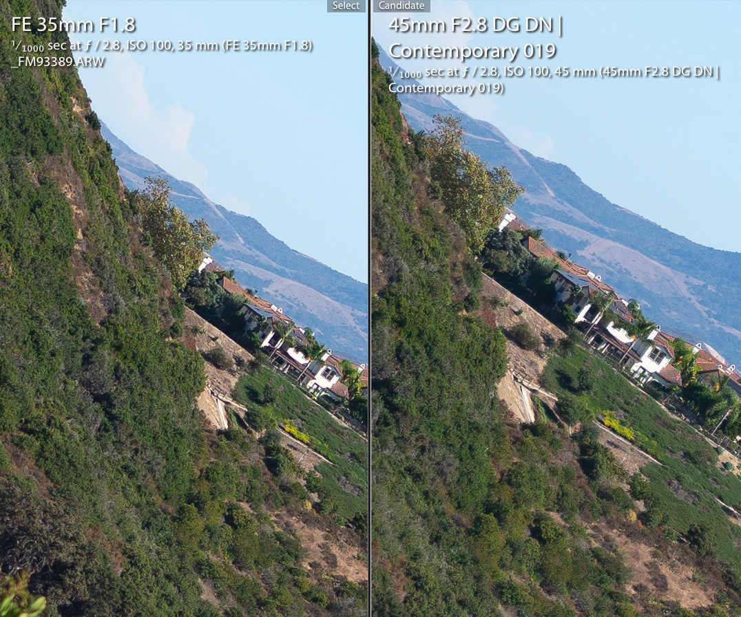

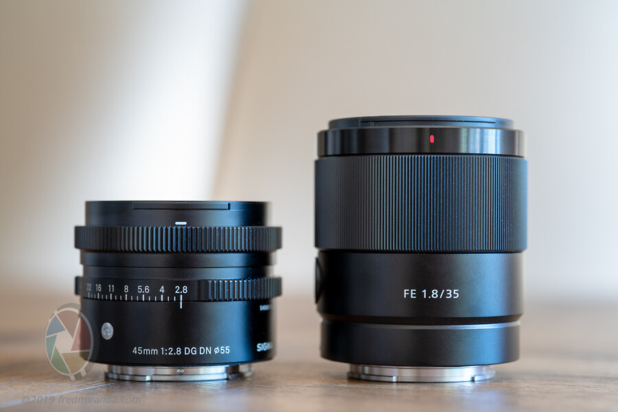

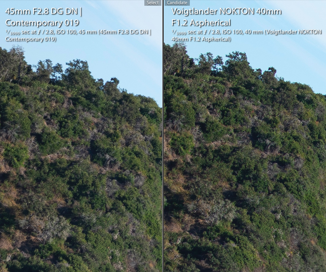

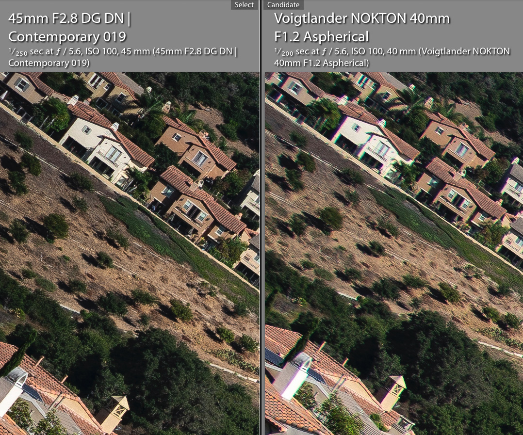

  3. Infinity Performance vs Sony FE 35/1.8
  4. Infinity Performance vs Voigtlander 40mm f/1.2

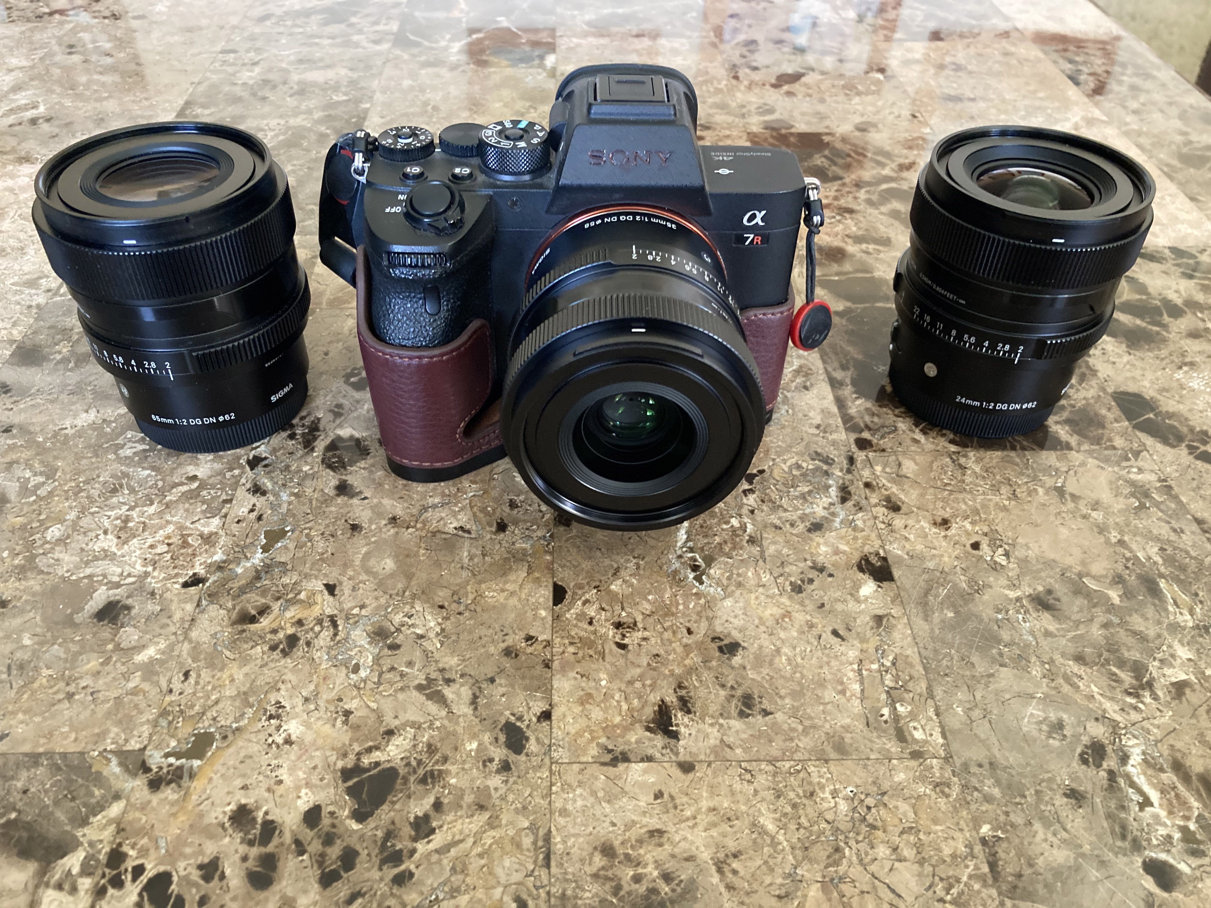

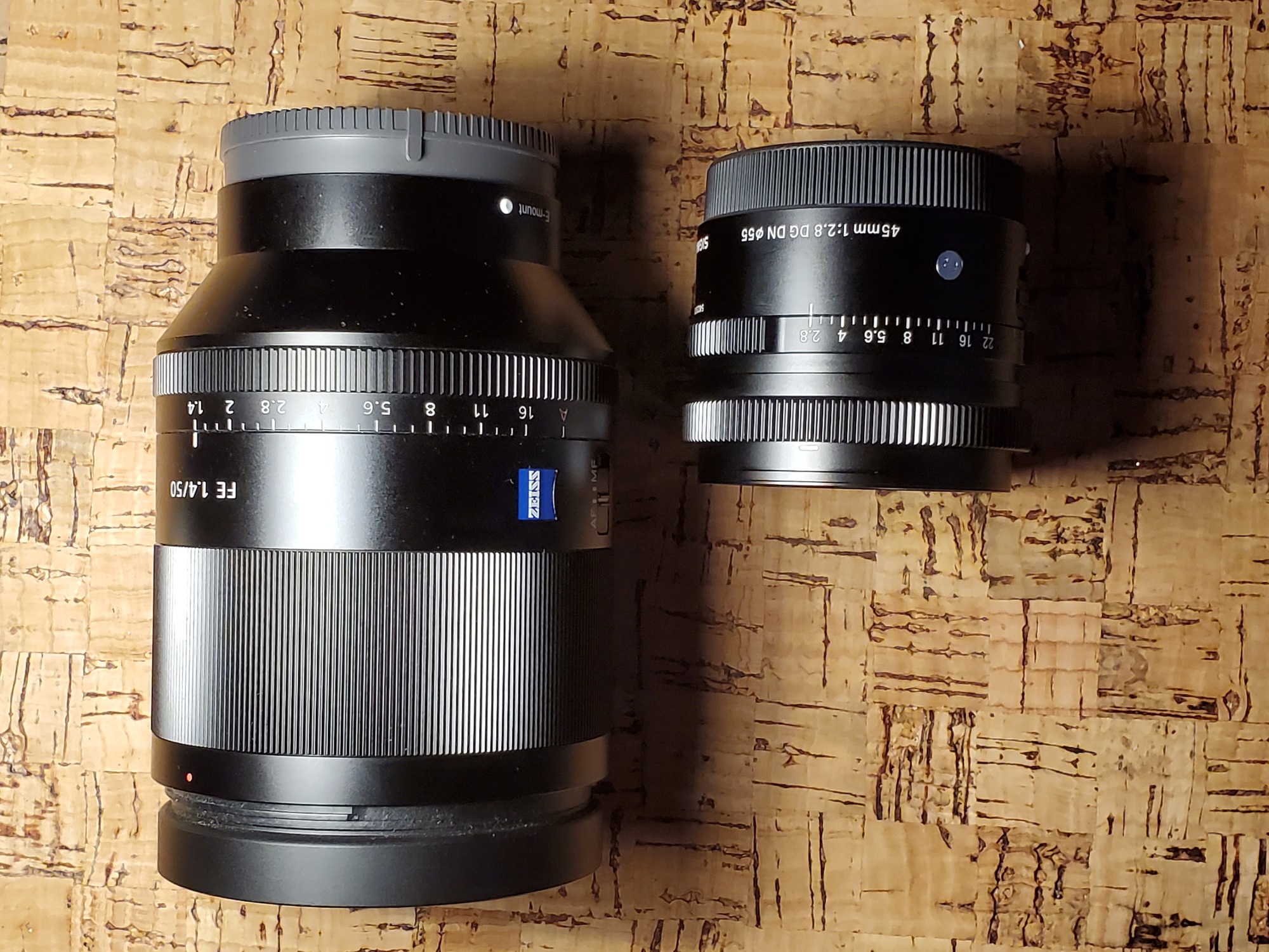

About the lens:
The Sigma 45/2.8 Contemporary E-mount is an intriguing lens and a welcome addition to the E-mount system. It's compact, light and delivers great optical performance without neglecting rendering.
The lens features an electronic aperture ring and a manual focus ring with a linear response. I like the design of the lens with the hood on - It’s all metal and well-built. The lens itself weighs a mere 212g without caps but the hood adds another 44 grams and extra bulk which negates the compact design when attached. There is also a MF/AF button.

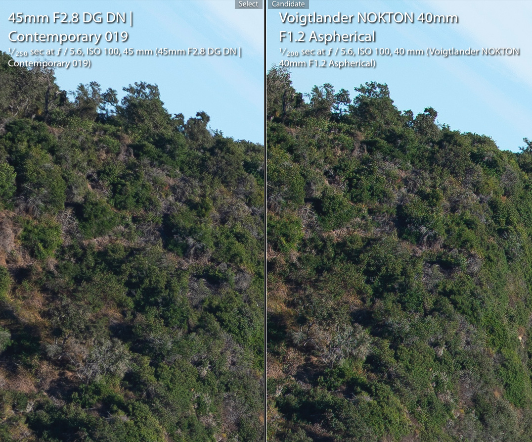

Infinity Performance:
The Sigma 45/2.8 Contemporary is optimized for infinity distance and it's already sharp from wide open (f/2.8) while showing noticeable improvement stopped down to f/3.2:
At center, it achieves optimal resolution/contrast at f/4:
Moving off-axis, the mid-field area benefits from f/5.6 for maximum resolution/contrast, although it's very similar to f/4.
The same can be said for the extreme corners where f/5.6 seems to be the optimal aperture. (f/2.8 and f/4 not too far behind)

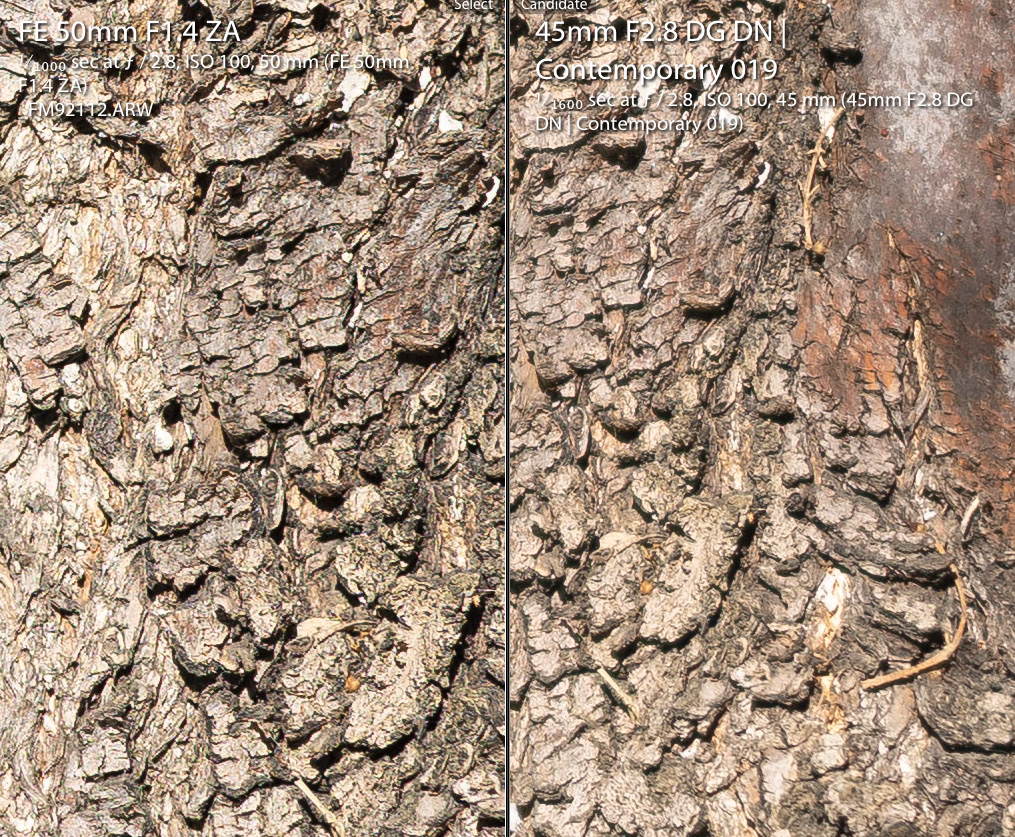

Close-up performance:
As mentioned earlier, the Sigma 45/2.8 is not optimized for close focus and does not feature a floating element system. From MTF until about 0.6m, it greatly improves when closing the aperture to f/4. After 1m, resolution and contrast improves greatly and from 3m to infinity it's already great from wide open.
Here are 1:1 crops comparing f/2.8 vs f/4 at various distances. (0.2m, 0.6m, 1m, and 3m)
Thumbnail at MFD (0.2m) showing the full image:
1:1 crop comparison from f/2.8 to f/4 at MFD (0.2m):
Spherical aberration is very noticeable
1:1 crop comparison from f/2.8 to f/4 at 0.6m:
SA still noticeable
1:1 crop comparison from f/2.8 to f/4 at 1m:
At this distance, the lens improves greatly and looks good even wide open
1:1 crop comparison from f/2.8 to f/4 at 3m:
From 3m to infinity, the lens performs optimally

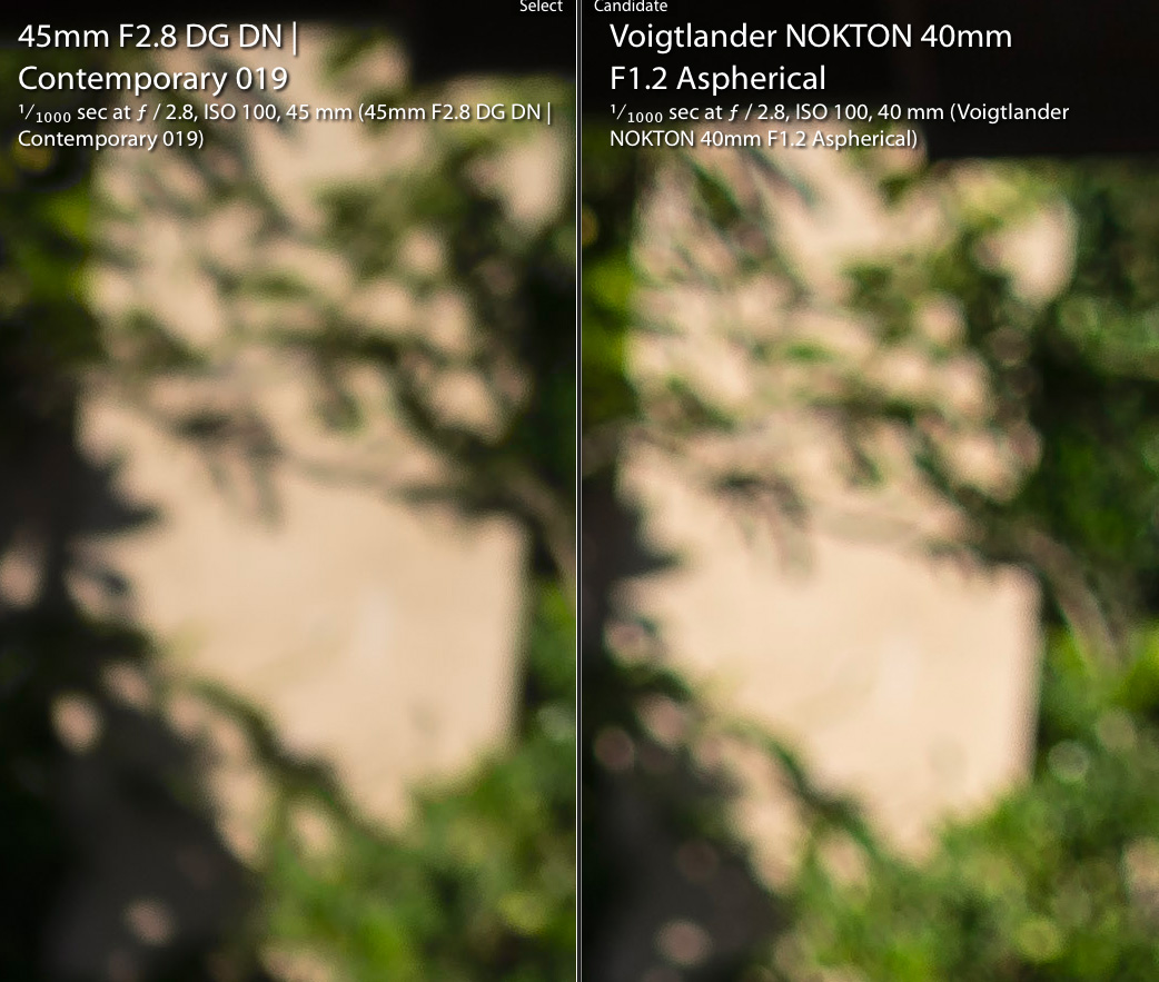

Specular Highlights:
The inner structure shows slight traces of onion ring pattern. However, it's not very noticeable in real world images.
Bokeh balls look good at close distance but its cat-eye shape is noticeable away from center. Here is an example showing f/2.8 (top) and f/4 (bottom) at about 0.5m. After f/5.6, specular highlights are no longer rounded.

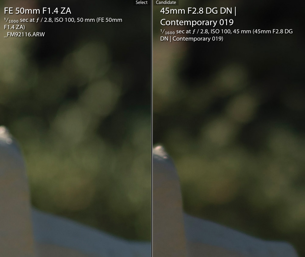

Rendering

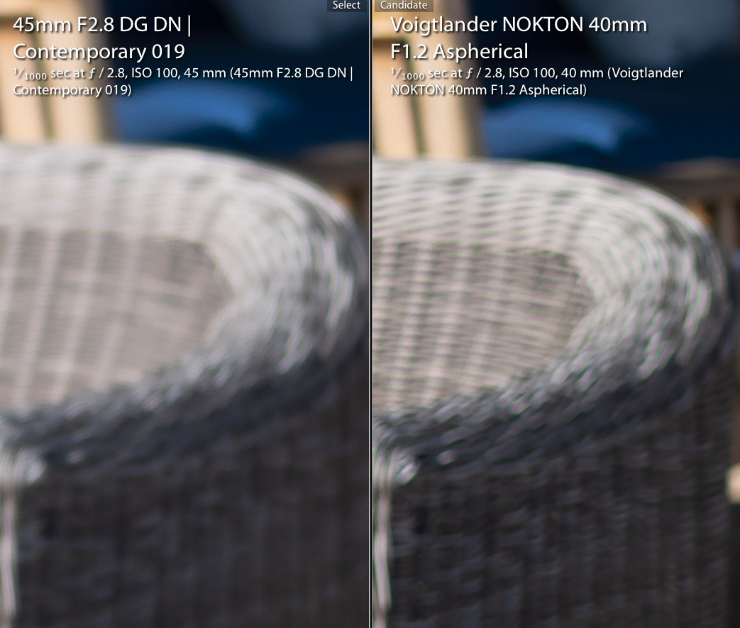

Out of focus rendering is the Sigma 45/2.8's biggest strength despite its slow aperture. I have a feeling Sigma optimized this lens for high resolution and contrast at long distance and rendering at close and mid-distance. Transition zone and overall rendering is very smooth from wide open.
Here are a few samples:

Sigma 45mm f/2.8 DG DN vs Voigtlander 40mm f/1.2 Nokton

Yay my wish came true, bokeh balls galore!

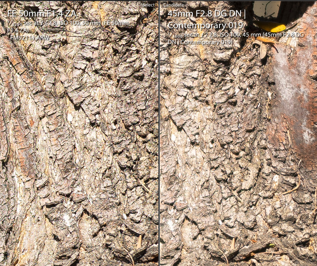

I’m curious how it compares to the lowly FE 50/1.8. You wouldn’t happen to have one on hand to compare would you Fred?🙂

As I suspected when it was announced, the lens has some good points, but not enough to make it anywhere near paying $550 for it. That price is sneaking up on used prices ($600-650) for the brilliant Zony 55/1.8. Plus, the Sigma isn’t appreciably lighter than the 55mm AND a full 1.3 stops slower. I think they would sell a lot more if it was priced closer to $300.
...Show more
Secondary for Sigma is pretty bad in general. I think a used copy might turn up around $300 eventually. I will wait for sure. No urgent need for this lens.
...Show more
I have the FE 50 and I would say that, in my experience and compared with Fred’s photos, the 50mm at 2.8 has a lot more LoCA (readily visible as green outlining / shadows in the background and also in the bokeh balls - the 45 looks so much more cleaner there). However the 50 @ 2.8 might be a tad sharper, at least in the central area. If time permits I’ll try to take a few sample photos showing this, by the end of the weekend.
