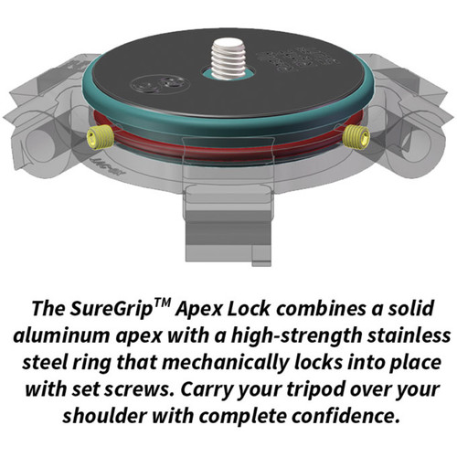

p.1 #10 · New tripod - Gitzo or RRS
on the subject of the adding and removal of the CP on a RRS or anything else. you feel that 3 screws is a hardship versus splitting what is supposed to be the strongest portion of your tripod, the apex as Gitzo does and have a clamping bolt? they had a little bit of history with that too. that history brought for a few 3rd party locking plates and a few redesigns. the RRS apex is designed to be the most rigid and secure setup for a modular tripod. and they are. of the 3 locking bolts that do secure it a single one suffices to locket in place. the other 2 just increase the lock/rigidity overall.
