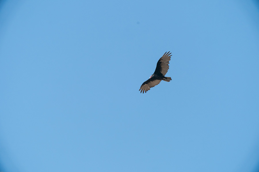

After reading about the 1.4 TC's heavy vignetting at the long end of the FE 100-400 GM, I tested mine, lo and behold my 1.4 TC had the same issue. I called Sony and was told that the serial number was within the problematic batch, or something like that. They sent me a pre-paid label to send it to Sony to exchange for a new one, but after they received it, they ran out of stock so they sent me a check ($549) to buy back the TC. Fast forward, I was able to buy another new one in May. Tried it on the 100-400 GM last weekend and noticed it behaved the same. Call Sony again yesterday and gave them the serial #, today they asked me to send it back to them to exchange for a new one.
I am wondering how wide spread this issue is? I wouldn't have tested my first one if I hadn't read Bob's report on this issue.

Here is a picture at 560mm:
Jun 22, 2018 at 09:22 PM

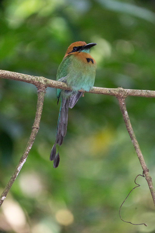

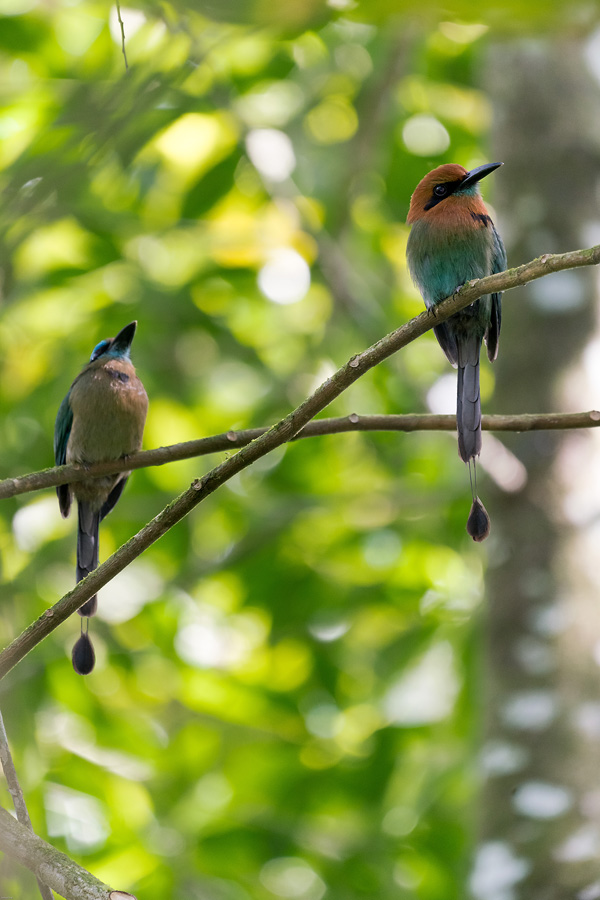

AGeoJO
p.1 #7 · Sony FE 1.4 TC Vignetting
I went back and look at images captured with that combo. Let me put it this way, I could see vignetting although not as severe as yours if the image has an even and bright background, like in the first image here, but definitely and significantly less noticeable if the background is busy, like foliage inside a forest or so, like in the second and third image.
These are just samples to illustrate my point and pretty much straight out of the camera and without any cropping. I lightened the first image a bit though. And both had the profile setting in LR for the lens.
© AGeoJO 2018
© AGeoJO 2018

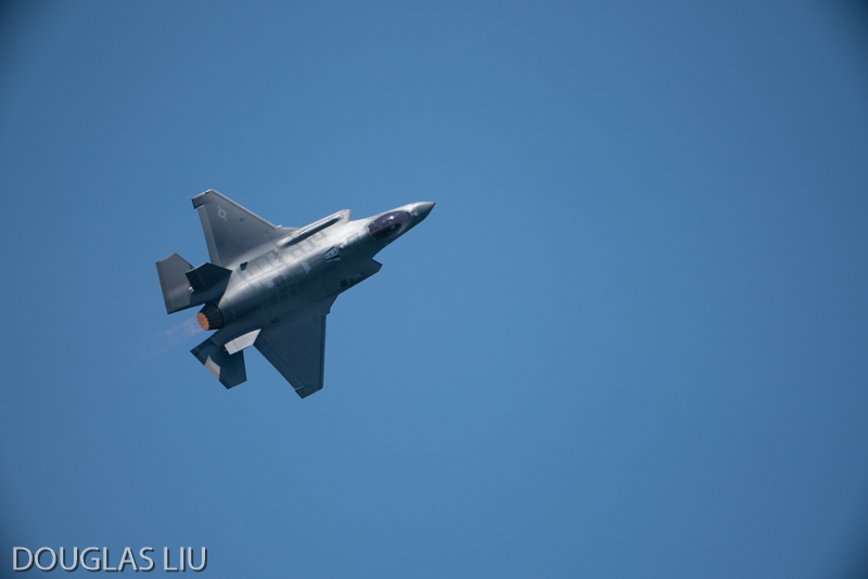

Hi Joshua, thanks for the advice! I sent both the 100-400 GM (occasional AF freezing) and the TC to Precision Camera (Sony's warranty shop) for them to look at, so I can't do the test now as you suggested. It puzzles me why some don't have that issue at all.
Cheers,
Actually I did have some shots at 400mm, here is one of them. There is a bit vignetting but one click in LR profile correct it was gone, nothing like adding the TC.

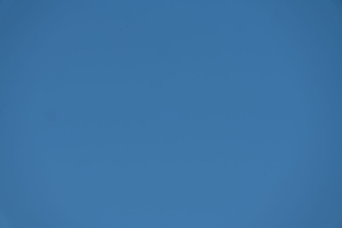

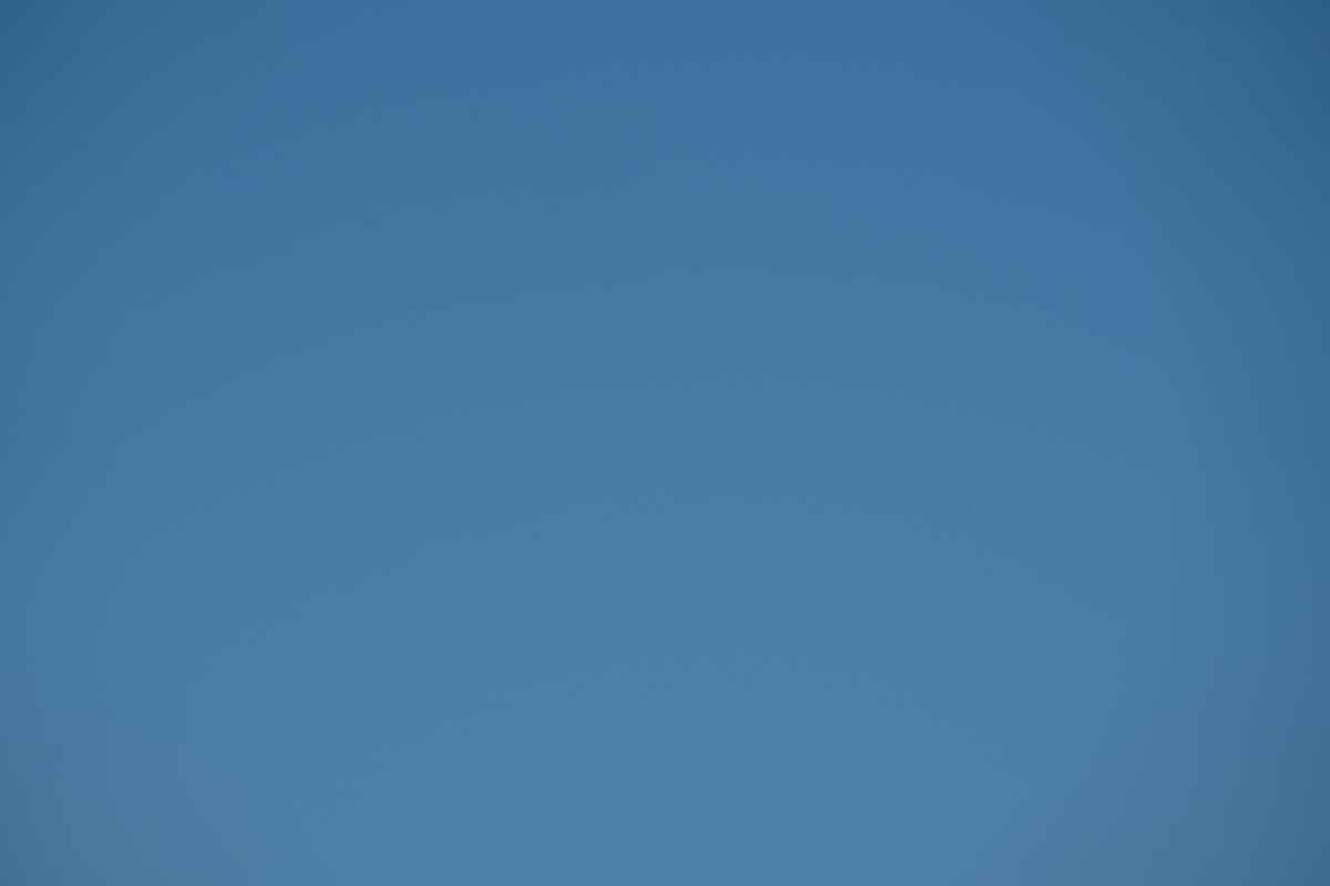

Here are shots of the sky with and without TC at 400 mm (560 mm with TC).
The only thing done was the "built in lens correction" in LightRoom.
With TC
Without TC

Thanks Kim! So it really is copy to copy issue. You would think a TC shouldn't have such copy variation...Maybe they had some bad batches.

Let me notice that there are clear traces of the vignette correction in the corners of the first picture (with TC).
