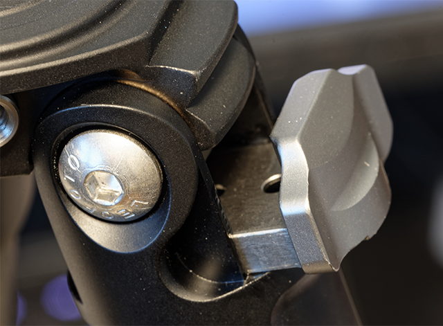

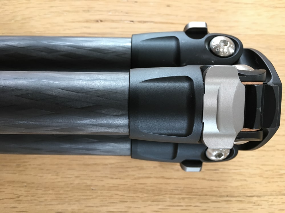

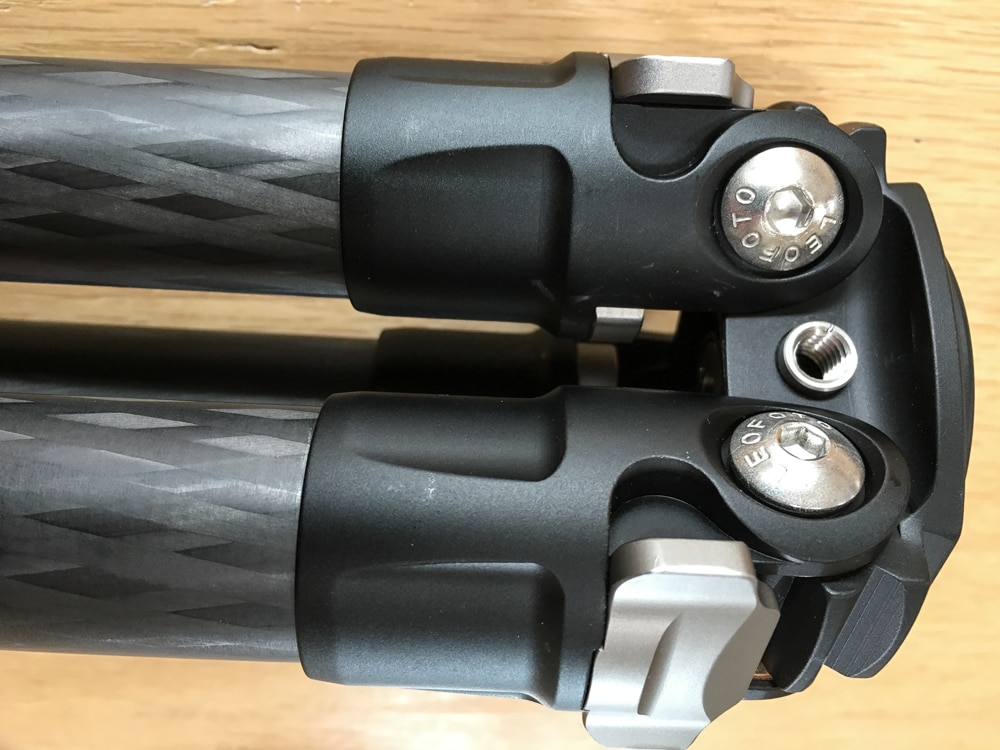

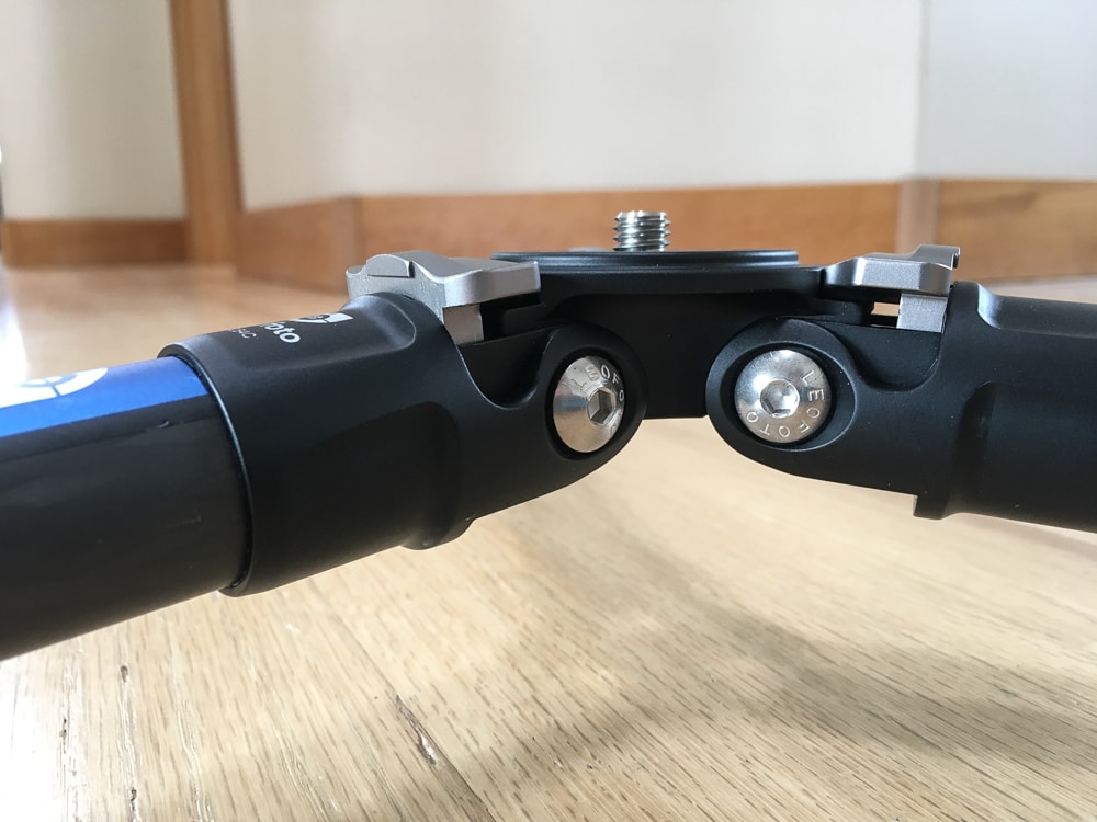

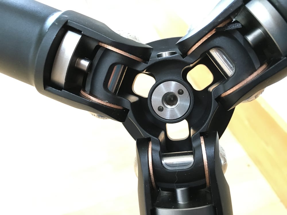

I think milling 1/32 or 1/16 inch from the top of the lock would gain a couple inches of spread at full extension, enhancoing stabiity. Sorry, my math is way too rusty anymore to give any sort of number.

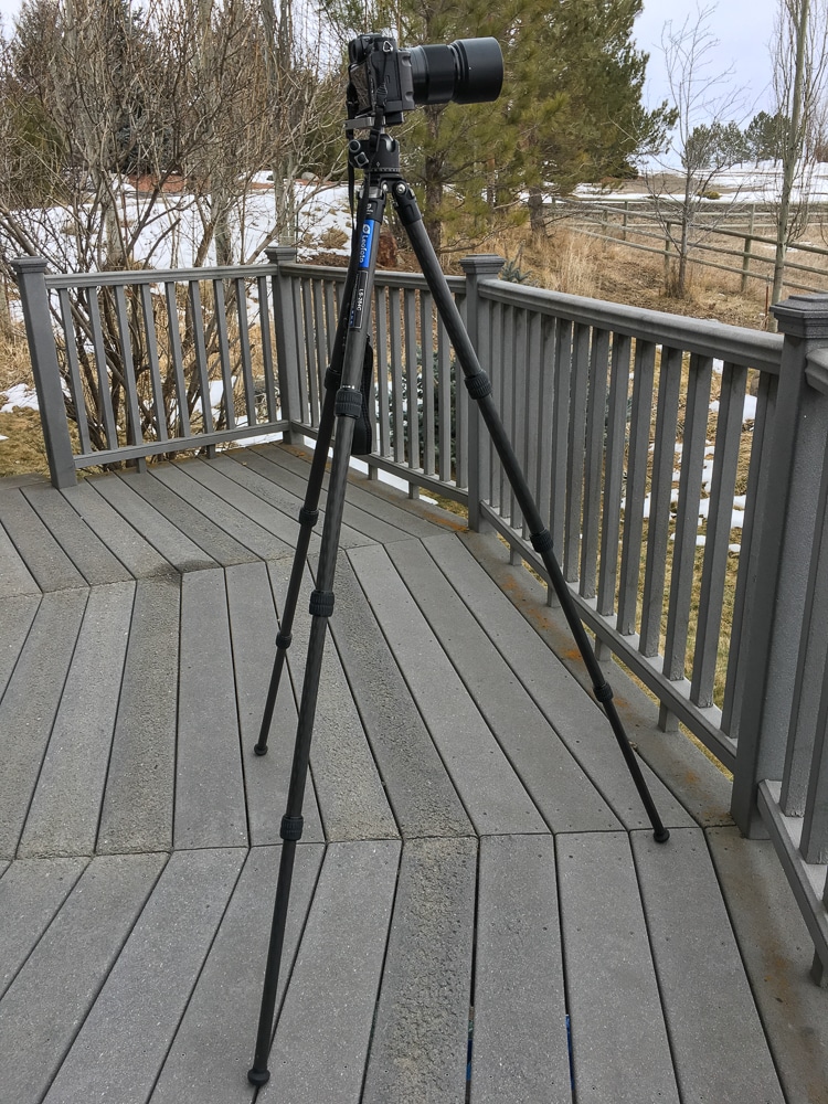

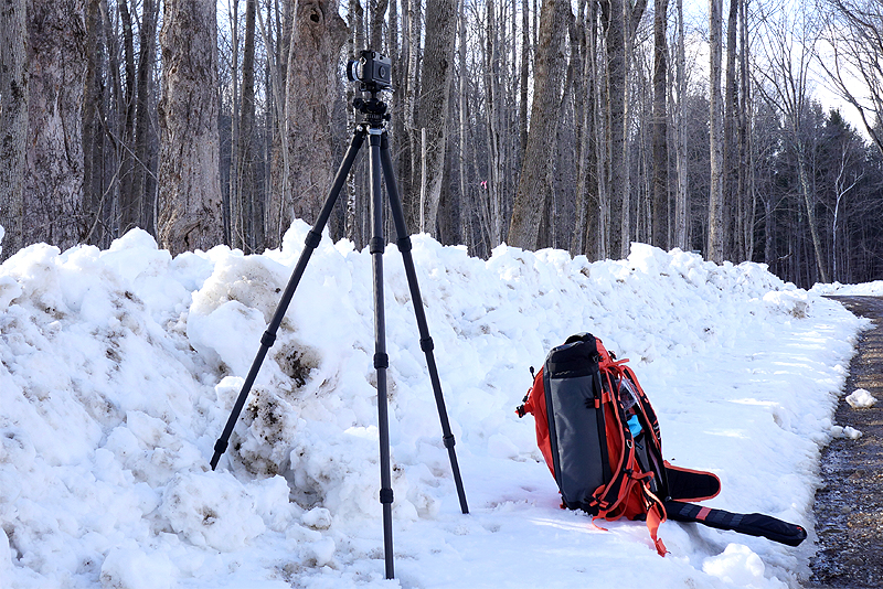

In the Berkshires. It seems to work well. Lots of snow on the ground here but the spikes held it steady on the side of a trail.
Good to know. I have not tried the spikes yet.
This is an interesting idea. It would be pretty straightforward to figure out how much to remove to gain a specific increase in spread.

The math is pretty straightforward. If r is the radius from the leg joint to the lock, and d is the amount shaved off of the lock, the then the increase in angle is given by inverse sine(d/r). Since d is quite small compared to r, this is approximately equal to d/r, with the answer being given in radians. To get it in degrees, you simply take (360/2pi)*(d/r).
Yes, as you spread the legs you lose tripod height. If the initial leg angle is given by theta, then the change in percentage terms of the height of the tripod is given by (d/r)*tan(theta).

I've thought about this to gain spread on my PMG tripod. But you'd need a jig to either cut all three at once, or do one at a time with the ability to dial in exactly how much to shave off at a time and make it repeatable.
I would use a router with a metal cutting bit, kind of like jointing wood, but no way am I risking a $1000 tripod!!!!
Mar 26, 2018 at 03:12 PM
runamuck
p.3 #8 · Review of Leofoto LS-284C Carbon Fiber Tripod (travel tripod)
It app;ears to be alouminim. You couold propbably file it off.
Mar 26, 2018 at 08:51 PM
sjms
p.3 #9 · Review of Leofoto LS-284C Carbon Fiber Tripod (travel tripod)
7075 aluminum supposedly. now you an use whatever method you want to try but you gotta get it precisely right on all 3 surfaces 120 deg apart, calculate leg angle/material to be removed, surface flatness and a few other things before having at it. otherwise you will not have a very level tripod in the end. personally i wouldn't waste $200 that way unless i have a guaranteed return for working it for a specific reason.
a nice lathe would help.

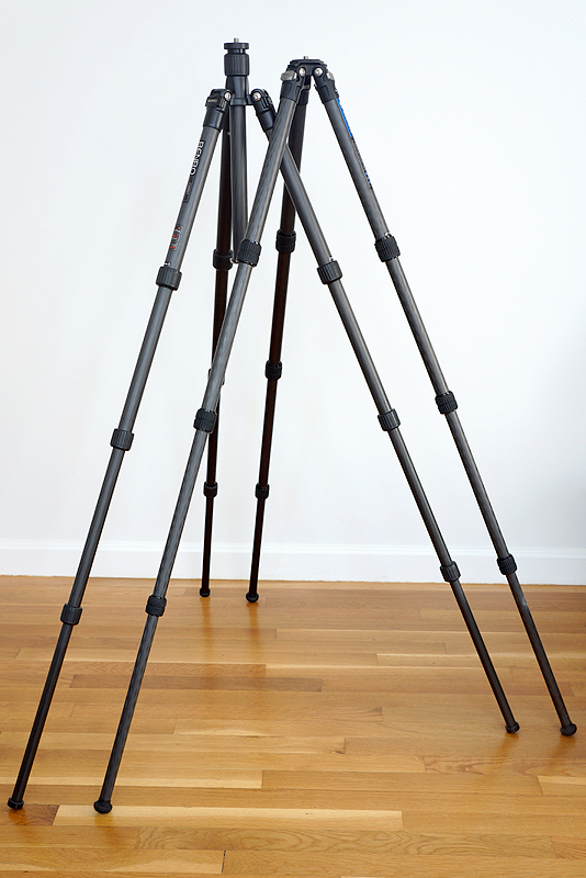

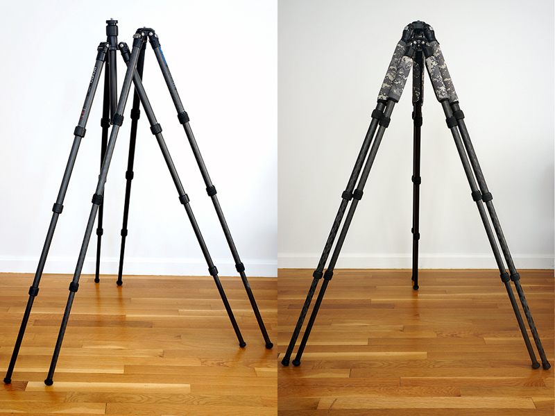

I have also used this Leofoto tripod on and off over the last month and it has replaced a travel tripod I've used for many years. It's just a better tripod; folds smaller, is lighter, and has aluminum hardware and better quality carbon fiber. I bought it on trial but I'm keeping it.
I understand that leg angle affects stability but this Leofoto isn't that different from most travel tripods out there. On the left below it's with the Benro tripod it has replaced, and on the right with a RRS TVC-24. The leg angles really aren't that much different, if at all. In the 8 years I've been using the Benro I've only experienced one issue with stability and that was on top of a mountain. I'm hoping nobody's trying to mill the stops to gain a bit of leg spread because this tripod has leg angles that are very similar to many out there.
