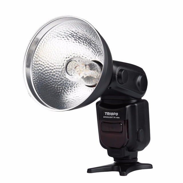

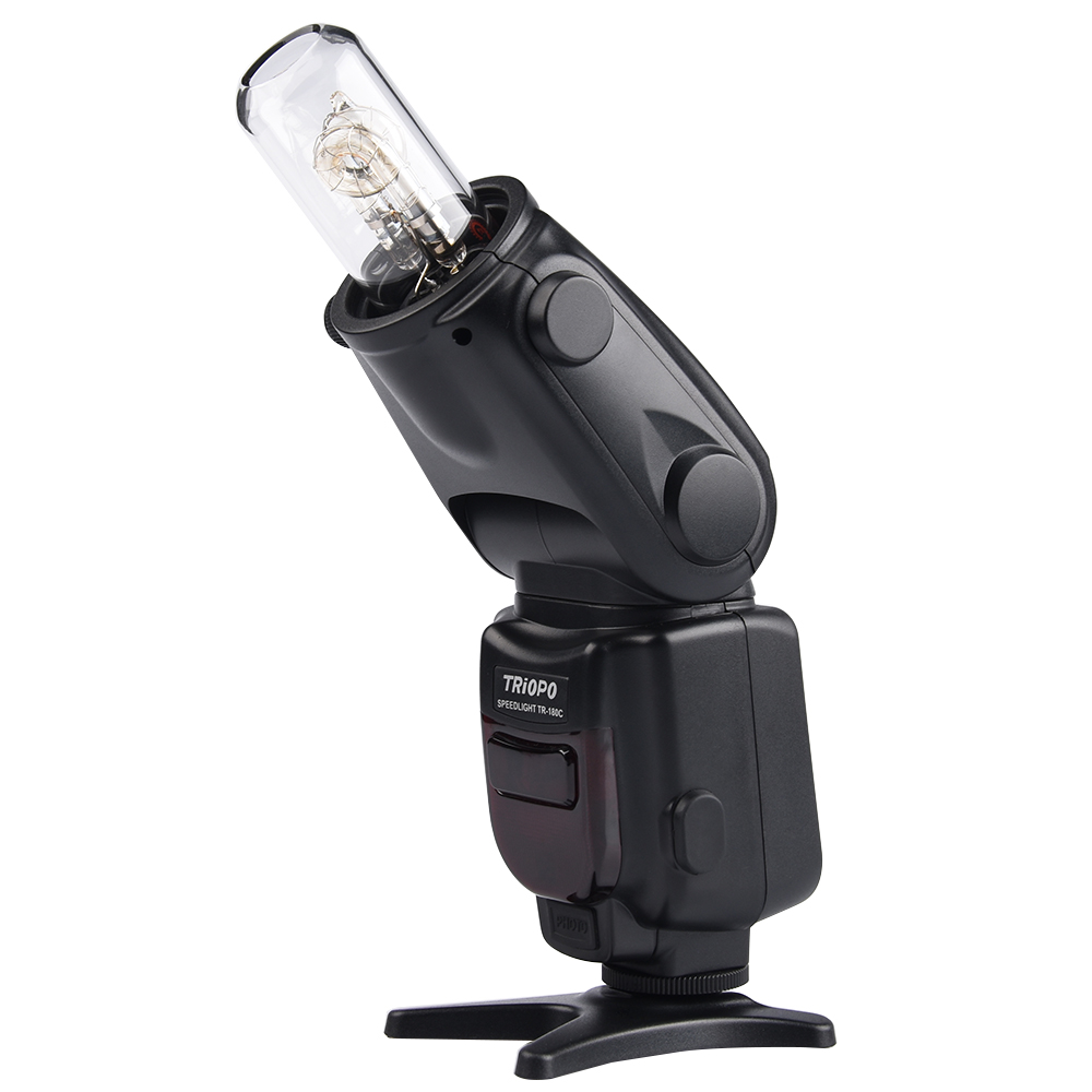

I have moved from Nikon to Sony and have two Sony bodies. I use the Sony's for available light shots, and my Nikon for Events in doors with a Quantum Qflash Trio. So my question is, Is there a bowl flash that works on the Sony? I know the hot shoe on the Sony has those small electronic connectors on it so putting a metal hot shoe sounds all bad. is there an adapter to insert into the hot shoe? Does Godox have a Bowl flash that will shoot TTL and high speed sync with the Sony A9?
I know I have a lot of questions. Thanks in advance.

Adam73
p.1 #18 · A9 on-camera flash options
timgangloff wrote:
I'm a bit clueless here, just ordered a Godox VING V860IIS TTL Li-Ion Flash for my A9. I'll be curious to see how well it works.
But, @Adam73@, what is a Bowl Flash?
This is a bowl flash, also knows as bare bulb without the modifier or bowl.
