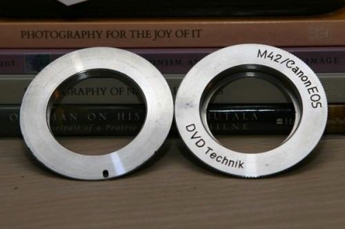

I've found lots of different ones work, but there's one gotcha.
Most M42 adapters have a small "ledge" inside the outer ring to push down the auto pins on later M42 lenses. But some early lenses (like many from Zeiss) won't focus to infinity with that ledge blocking the way.
I found this out after much trial and error and surprisingly my Zeiss Biotar 58/2 works well with a cheap $5.00 m42 adapter.
