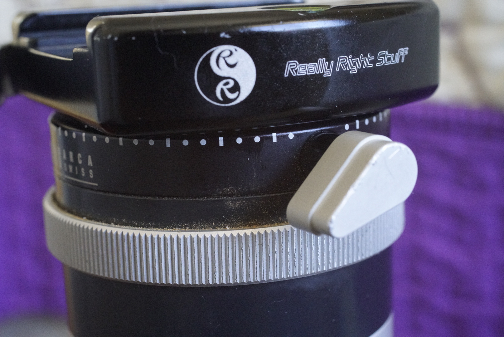

I was thinking when I looked closely at the P0 design details that they needed to put a seal at the top of that locking ring to keep it from collecting grit and possibly forcing it into the mechanism eventually. This photo confirms that feeling I had.
However, It may not be a problem at all in actual use. It would be nice to see that mechanism a little better designed for dust, though.
