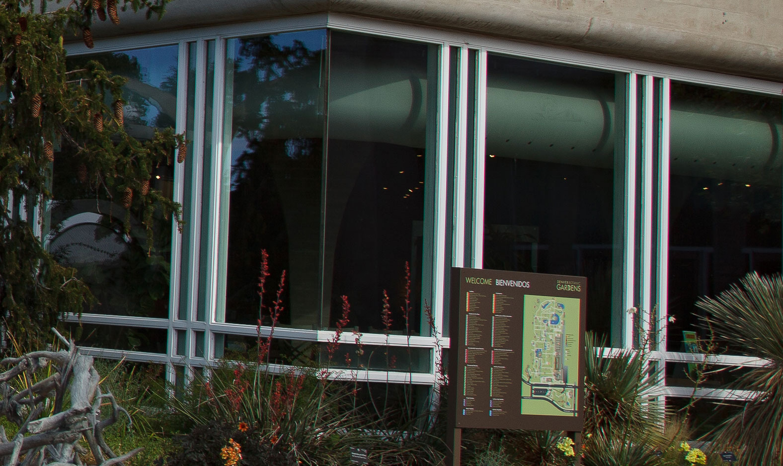

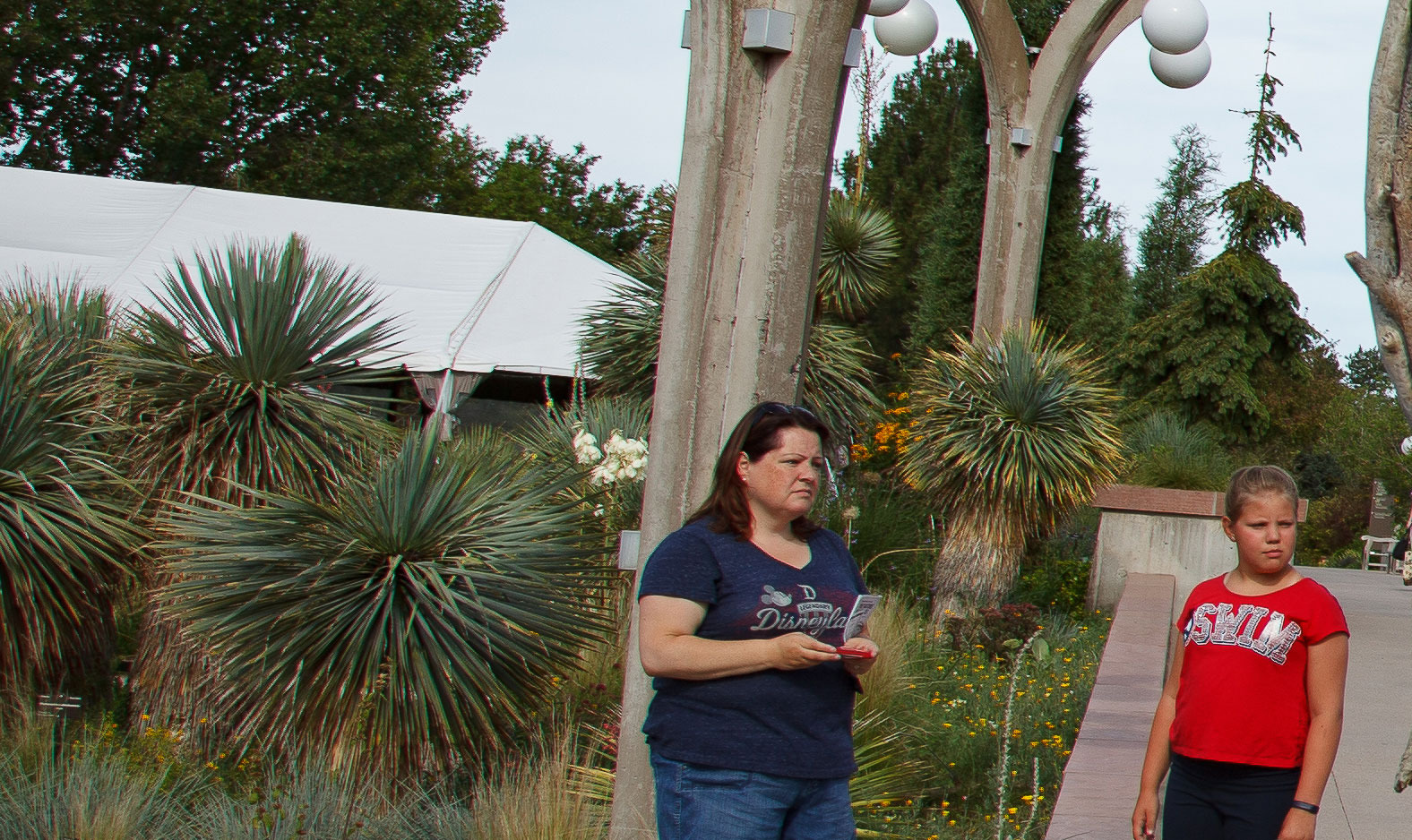

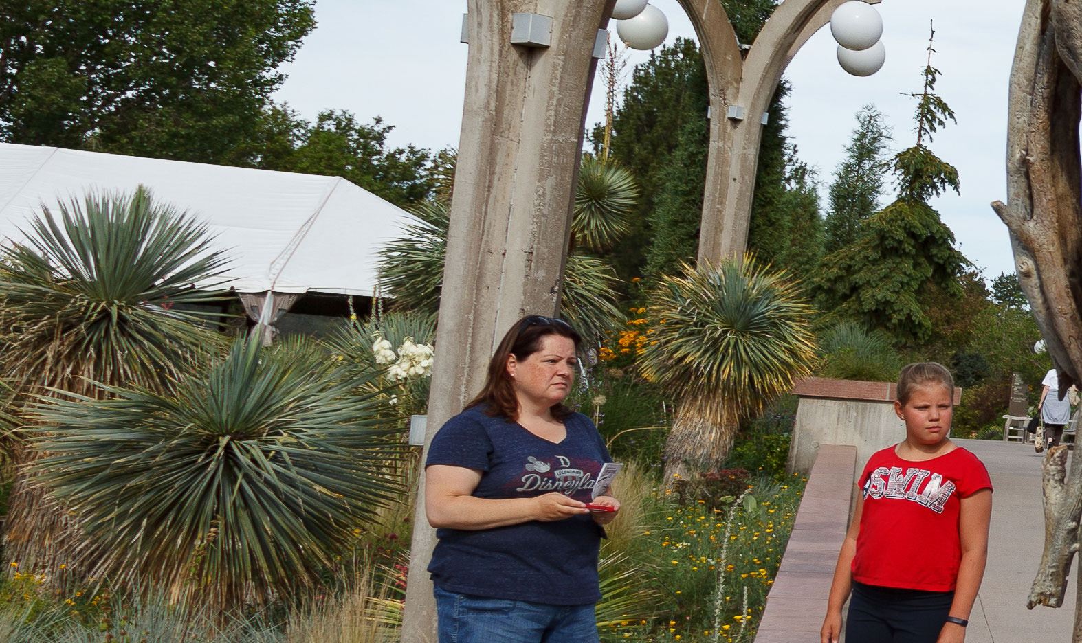

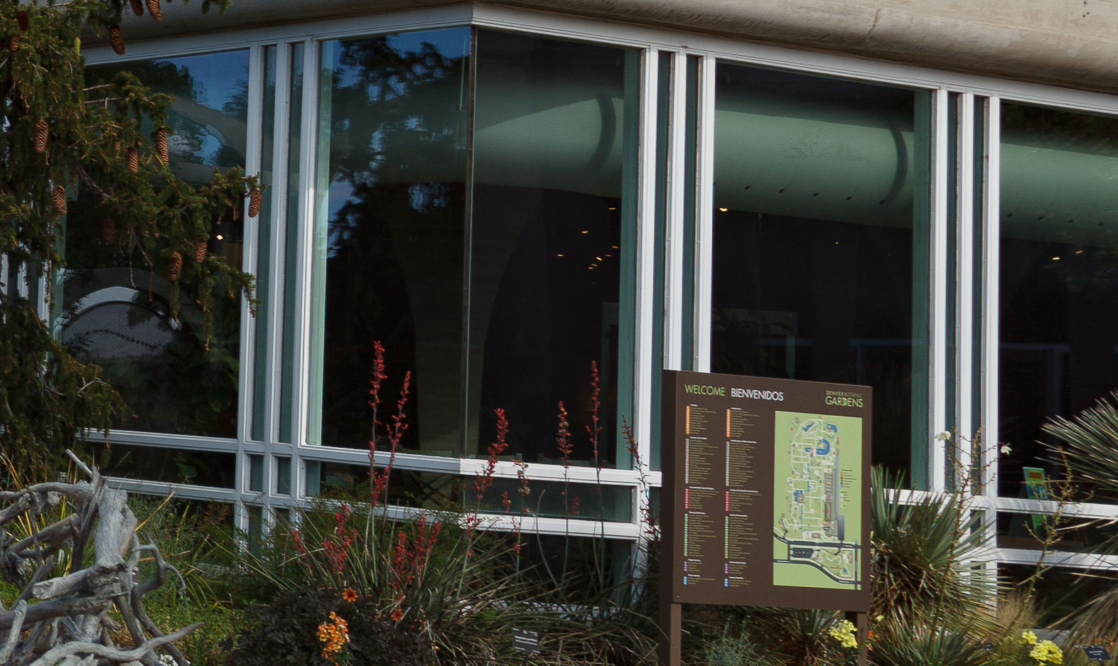

I hate to cast myself as the 24-105L Apologist, but I've had really great results with mine. I'm going to try to provide links to two versions of an image shot last weekend in RAW and converted with minimal PP in LR6 to jpgs and hosted on Photobucket (haven't used that account in forever!). We'll see if it works.
The shot was a "warm-up", so no special attention paid except to exposure and general framing/focal length. Please ignore the people's expressions and tilting of the camera!
The first version is with the lens profile turned off and the CA correction turned off. Yes, there is some CA, but overall sharpness at f/5.6 is pretty astounding, and fringing only shows up (mildly, but notably) on high contrast edges, particularly on the image edges.
The second version is with the lens profile turned on and CA set to "1". This eliminates all CA fringing for my purposes.
I think in tests, along the lines of those you have provided, it is good to show results, or remind readers, that the CA is quite correctable in most lenses and doesn't significantly impact edge sharpness -- certainly improves over the CA smearing. I'm a fan of showing images with normal PP and in context of final use.
Let's see if this works where you all can see the images at 100% image. If so, please note high contrast edge details and center sharpness (somewhat behind the driftwood horse sculpture).
(PS -- Well, that didn't do the 100% I'd hoped. Let me see if I can pull some 100% crops of details. )
Without profile or CA turned on in LR6
With profile and CA correction applied
Edited on Jul 22, 2015 at 11:39 AM · View previous versions
Jul 22, 2015 at 11:06 AM
Gunzorro
p.3 #15 · 5DSR Mega Landscape Lens Test [Updated 7/27]
Maybe now. . . ?
100% crops with no profile or CA correction vs. crops with profile and CA turned on. LR6 2015CC for PP.
Please look to the area of the window dividers on the right crop, and the trees/sky-tent-light globes on the left crop.
I don't need to show the center, do I? It's even sharper and less CA in the uncorrected and corrected versions.
The caveat to introducing corrections is as Peter stated, resolution suffers slightly, as can be seen in comparing the lettering on the sign from crop on the far right. Less correction could be applied, or more deftly applied -- these are fast and dirty crops for illustration of my experience with the 24-105L.
I don't doubt there is wide variation in production of this lens, as many experienced owners have stated, but I overcame my own reluctance and finally purchased about two years ago, and now it is my most used, go-to lens, unless specific other needs present themselves (TSE, UWA, etc.).
I'm open to someone questioning my sanity or powers of observation! To me, this shot looks pretty good un-corrected, and great corrected, considering shot on the fly, hand held for a simple "get-in-the-groove-of-the-shoot" shot. I'm open to improving my work if anyone has a more practical suggestion at reasonable price for higher IQ with the zoom range.
No profile or CA correction
Profile and CA +1 correction applied
Jul 22, 2015 at 11:35 AM
