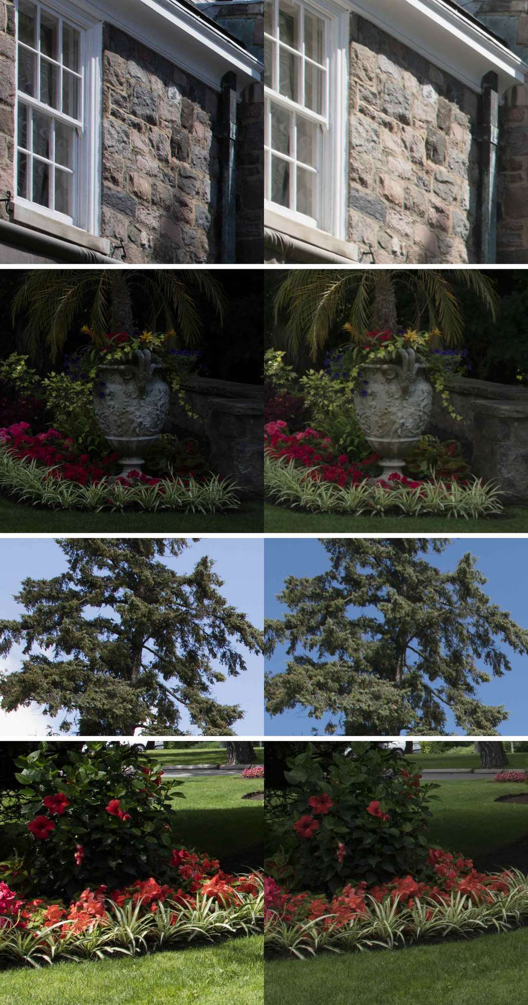

Moroni
p.2 #13 · 16-35 f4: Canon vs. Sony
I found the link. Please note the image is highly compressed and the difference is more noticeable at full resolution:
http://photography-on-the.net/forum/showthread.php?t=1437260
I attached a side by side comparison of a few crops from the images. All I did was open the RAWs, turned the noise and sharpening to zero, and resized the 5DSR image. Obviously the lightening, framing, etc. is not identical but I think its a valid comparison overall. Not perfect or ideal of course.
As you can see the amount of detail the Canon/Canon combo produces is very noticeable compared to the Sony. I was thinking the differences would be much smaller especially considering the only variable is the sensor and adapter. Perhaps the adapter is the issue? Regardless, I personally would not be happy using the 24-70 Canon lens on the Sony.
IMO, the difference is not subtle. This image combined with a few examples led to my decision to not use Canon lens on the Sony A7R II. I think the adapter is affecting IQ more than most realize.
-Brian
Aug 23, 2015 at 06:59 PM
mogul
p.2 #14 · 16-35 f4: Canon vs. Sony
Without knowing focus point, they are just pictures.

Moroni
p.2 #15 · 16-35 f4: Canon vs. Sony
The RAWs are all available in the link, if you'd like.
These are not my images so feel free to ignore if don't find them applicable or informative.

Steve Spencer
p.2 #17 · 16-35 f4: Canon vs. Sony
...Show more →
Why are the exposures so different in these tests? Did they explain? The first two the Sony is more exposed by quite a bit and the second two the Canon is quite a bit more exposed. Did they say what adapter was used? My own view is making a decision from any one test, unless it is with your own gear, is probably not collecting enough information. There are just too many things that can't be held constant with such a test, but YMMV.
