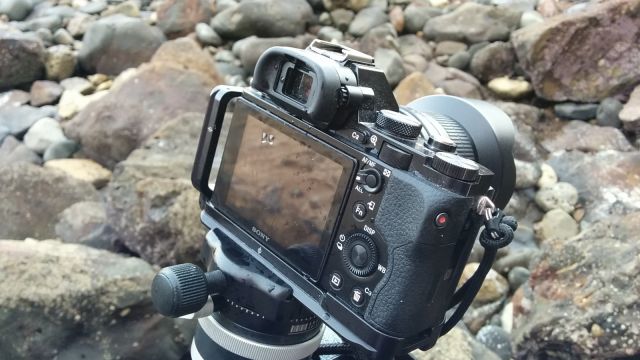

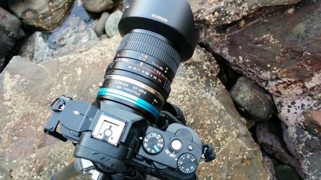

I've gotten my camera wet multiple times, here it is after I was hit by a rogue wave the other day.
I did a quick wipe down of the camera before I took this photo, and there's still residual water.
no way would I purposely get my gear wet though, if it rained during the hike, it would go inside my bag regardless of dslr or mirrorless.
