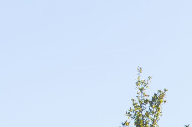

So I had the sensor to my M-E replaced this January 2014.
Today I checked it for 'corrosion'. Shot it into the sky at f16.
Yup, amongst the regular dust spots, there was one corrosion spot. The tell tale semi transparent ring around the darker center.
The new sensor lasted less than a year before it corroded. I live in dry Southern California.
It was never wet cleaned.
It took 4 months for the last repair.
I'm going to keep using it until it gets much worse, because I'm not going to send it in until the new sensor design is available.
That would be the most sensible thing to do. Even if no long term solution is found, Leica will replace the sensor anytime there is corrosion. It would be better to wait until the spots get too many to clone out, probably every 2-3 years in your climate.

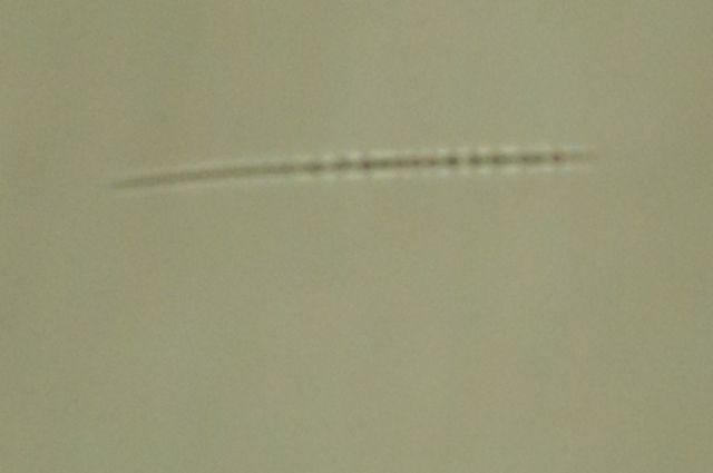

Is this the corrosion issue? This is a high ISO and high aperture shot of a window shade and zoomed in at 300%.
Dec 14, 2014 at 07:03 PM

p.4 #6 · Leica M9 Class Sensor Issue
and here is a month ago and then a month before that. I cannot find it before mid October at all. This seems to be rapidly deteriorating... not happy.

Katie, that doesn't look like corrosion to me. It looks like a cleaning mark. However to be sure do not attempt to clean it by yourself. Send it to Leica for cleaning and if they find that it's corrosion they will replace the sensor for free.
