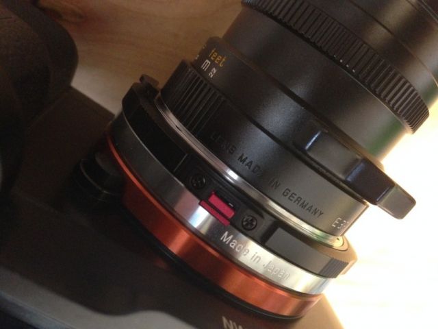

Dan @MaxMax said he's done a few A7/A7R conversions but hasn't done an A7S yet. He did confirm that the A7 series sensors can't be moved forward so you do need to modify the mount/adapter distance.
The newest Hawks adapter does have infinity focus adjustment, but I believe so does the new Voigtlander adapter. It doesn't really appear to be documented anywhere, but I see two screws surrounding the infinity lock plate, which alludes to it being adjustable.
Aug 29, 2014 at 01:40 PM
hiepphotog
p.1 #13 · A7s is great with all RF WA and UWA?
I think that is just to hold the tab in. The Hawk's has 4 screws at that position (2 to allow adjustment, and 2 to hold the tab).
Aug 29, 2014 at 02:40 PM
Dustobub
p.1 #14 · A7s is great with all RF WA and UWA?
Ah! So you're right. Damn. Well the newest Hawks could be an option, but I still don't know if it has enough freedom of adjustment. It'd be much better if the entire sensor mount could be moved, but Dan @MaxMax said it's never been attempted and certainly wouldn't be easy to do.
