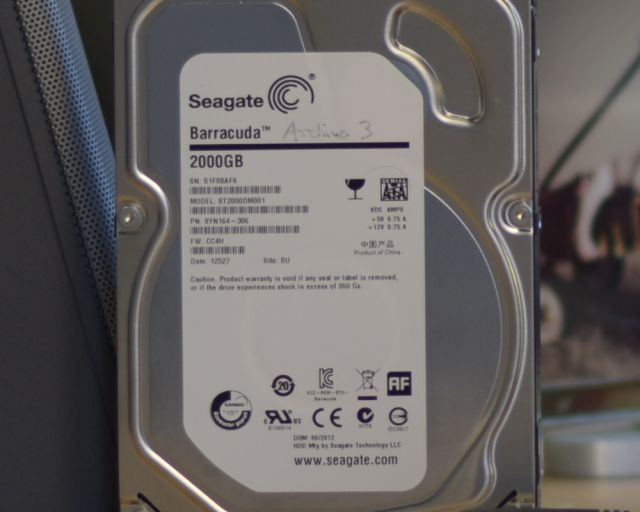

p.1 #17 · Nikon 85mm f/1.8G - Sharp Enough?
The shot of your wife is also not sharp. The focus appears to be on her arm rather than her face. Either way, it's nowhere near where I would would expect with a D800 + 85 f/1.8G.
Jan 06, 2014 at 04:42 PM
