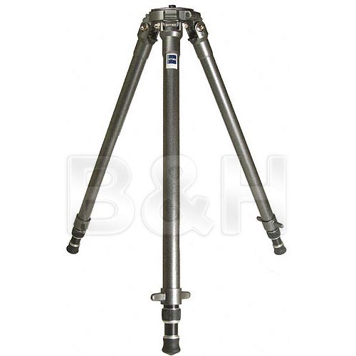

a g1410 was/is a solid performer
Specifications of Gitzo Series 4 Aluminum Systematic Tripod - 3 Section G1410:
attachment: 3/8'' screw attachment type
bubble spirit level (no.): 1 number
center column: no center column
closed length: 29.92 in
leg angles: 24°. 55°
leg sections: 3 number
load capacity: 35.27 lbs
material: aluminum
maximum height: 64.57 in
minimum height: 7.48 in
series: 4
weight: 8.38 lbs
with those specs for its time it was quite the beast.

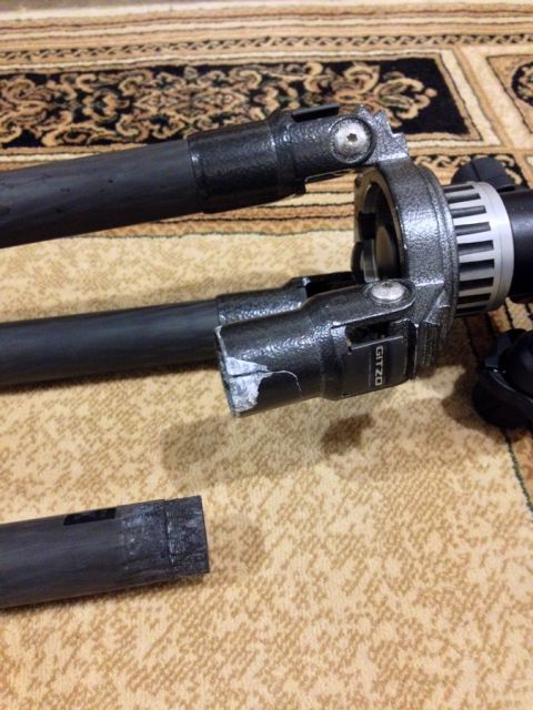

For what it is worth, it doesn't look like corrosion to me. The white dust looks more like a paint layer between the outer coating and metal. The flaking-off of the paint layer would be expected with the deformation of the underlying metal substrate. Also the crack propagation looks like a brittle fracture through the metal, not a failure due to corrosion eating away the metal. The edges on the crack don't look fresh, so it may have been around a while before the failure was noticed. I would need to stick it in my (work) electron microscope for a
...Show more
Magnesium Oxide is white ( http://en.wikipedia.org/wiki/Magnesium_oxide ). I have worked on the corrosion of magnesium alloys for a long time and that is what corrosion of magnesium alloys looks like, particularly under paint. I have seen that many times. You are right in that an elemental scan in the SEM would confirm that rather than making it opinions. As to the fracture, I agree that it would require microscope evaluation to determine if it is brittle or ductile fracture, or fatigue fracture. It is nearly impossible with the image shown to determine the nature of the crack. Most magnesium alloys have fairly limited ductility due to their crystal structure. So, I am not sure how much ductility one could expect to see.
I was wondering if corrosion between the carbon fiber tube and magnesium lug placed the magnesium under a enough stress that it cracked it. I have seen that happen in other industrial corrosion situations. If you get a crevice attack, the expansion of the material from the metallic state to oxide can generate a surprising level of stress.
-Cliff
Jan 02, 2014 at 05:22 PM
sjms
p.6 #9 · Gitzo Tripod failed again!
I deal with many different types of corrosion daily too. but that is just an exercise in over analysis. it showed signs of substantial corrosion under the paint. a tripod is a device that is subjected to multi axis loading and is usually top loaded by the weight of what is carrying, handling and environment. the area was weakened and mechanically worked. in the end it failed.

I have had this happen with TWO of Gitzo models.
The first was a CF just over 5 years old and the joint that tightens just gave way under load. I thought...' just a fluke '. So I bought into them again.
3 years, 5 months in, the same breakage as shown by the Op. Of course not being a paper-hoarder, 3 years is a long time to keep paperwork. I took the loss without being able to prove purchase date and left them FOR GOOD.
Yes it's a PITA to lug a 055 series Manfrotto around.... But it's notgoing to same route as those others, I can guarantee that. I've thrown everything you should never throw at 3 legs and it's like the day I bought it..
Gitzo = Tiffany's, you're just paying for a name.

I just can't understand why Gitzo doesn't use stainless excusively at the high price points. It would be a little heavier, but not a lot, but the cost difference should not be great. Right?

Jeffrey wrote:
So, you're basing your decision on just one case?
Yup. Just one case. That's all it takes. "Cause I have just one $12K lens, just one $7K body, and most importantly, just one heart... that cannot endure an attack from watching those other ones tumble to the rocks and break into twos.
Speaking of ones into twos... on this thread alone, since post #1, post #'s 6, 15, 18, and 10 two posts above came along soon afterwards and reported several more incidents of failure on these high dollar, top of the line ($1K) Gitzo tripods. That's enough for me.
Many thanks to the OP for posting the images of how the leg socket cracked. That macro image offers at least one plausible reason why ENG broadcasters and cinema DP's don't use that style of stick construction to support their heavy rigs.
