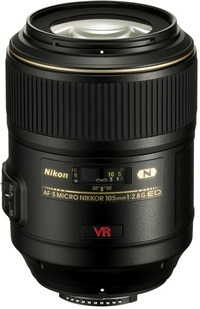

I just purchased a d800e and wanted to get your opinions on macro lenses for use in jewelry photography. I photograph a lot if smaller gold pins and chains and some diamond pendants and necklaces as well. Your opinion is greatly appreciated.
Some of the ones I have been looking at are the 105vr Nikon, the 150 sigma, and then the slightly out of my price range Zeiss 100mm f2

The Zeiss does only 1/2x mag and the barrel extends when focusing. Those two are my nits about this lens. For macro level work, you probably will depend more on MF than AF, so the MF Zeiss works very well.
Said all this, my recommendation will be the Nikon 105VR.

I have the 105VR, and it does a great job with my casual macro work, while also giving me a decent VR portait lens and short tele. But if you are wanting to do primarily macro work, the focus breathing might drive you crazy. As you focus, the object grows/shrinks in your viewfinder, so you may need to reframe. This is one of those cases where Ken Rockwell was right, and I should have listened to him.

I new or used Nikon 105mm VR lens would be my first choice. It is long enough for jewelry sized items and provides enough working distance for flash. The VR helps for non-flash or fill flash photography and is a good general purpose and portrait lens.
