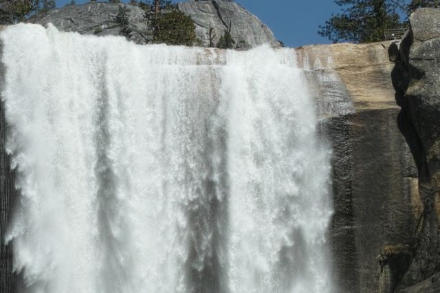

I spent spring break in Yosemite, and used the opportunity to test out my new Sigma DP2 Merrill. I'm a longtime Canon shooter, and enjoy my Fuji X100 as well. But the buzz surrounding the Sigma foveon sensor and the "46MP" Merrill cameras finally got to me. I brought both the Sigma and my 5D3 to Yosemite and thought I would post a couple comparison shots.
Below are some non-scientific comparison shots using both the DP2M and the 5D3 with 16-35mm L II lens. As a reminder, the cost of the Sigma DP2M is $800, the Canon kit roughly $4750.
In general, I found the uncropped 5D3 shots more pleasing to the eye, which is the ultimate priority, but the resolving power of the Sigma is pretty amazing. My main challenge with the Sigma IQ involves color rendering, for which I favor Canon.
The main point of the following images is for general IQ comparisons, and more specifically for the amazing detail the Sigma can provide.
Thanks for stopping by
Jim
Sigma DP2M - Vernal Falls
Canon 5D3 + 16-35II - Vernal Falls
Sigma DP2M Vernal Falls Detail
5D3 Falls Detail

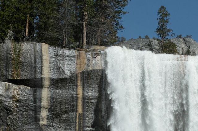

Sigma DP2M water and railing (top right) detail
5D3 water and railing detail

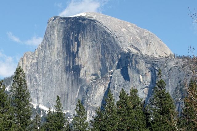

Sigma DP2M Half Dome
5D3 Half Dome

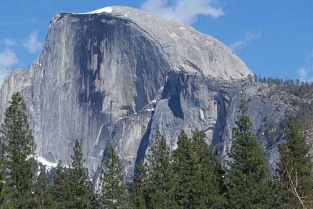

Half Dome detail
Sigma DP2M - Half Dome detail
5D3 - Half Dome detail

Wow....Not even close. The Sigma images have much more detail.

Very interesting, but I'm not sure how much can be concluded from the detail shots...the significantly different effective focal lengths would be putting the 5DIII at a significant disadvantage for resolution...and the Sigma Merrills have significant resolution at the pixel level. I'm not really clear how the shots were taken; i.e. how was the similar framing achieved with the 5DIII @ 31mm vs the Sigma at ~50mm 'effective' focal length? Am I missing something here?

For the half dome pic. How does the apsc Sigma at 30mm have the same framing as the fullframe 5D at 31mm? Curious about your test procedure.

are the 5D3 shots sharpened? they don't look it.

Comparing 30mm on crop AND fullframe pretty much makes the comparison void, no?

I am not surprised by the Canon crop, but on the other hand the 16-35 is not as good a lens as the Sigma 30mm, and f/11 is stopped down enough to at least wonder how much of the resolution was lost to diffraction.
A much better comparison would be a Zeiss Planar 50mm at f/8 and the Sigma at f/5.6 or so.

Give or take a little on focal length. Give or take some on F stop. Resolution differences to this extent is not minor, it is massive. Lens resolution? Yes that is a huge factor. The 16-35 is not an awful lens, far from the best but not bad at all. A m4/3 16mb sensor, diffraction kicks in very early, but even on those sensors not to this extent at f11, so I would not put it all down to diffraction, if any at all.

Also the Sigma Vernal falls crop looks way over sharpened/LCE'd. Yuck!

As I said, this was an unscientific comparison. It is guilty of all the testing flaws (except sharpening) referenced in the post. I was mainly there to hike the trails and be in the landscape. That said, I took A LOT of comparison images using same technique from same spots, and even given the focal length differences (31mm to effective 45mm), the results were very consistent: The Sigma always provides more detail, well beyond what a traditional dslr sensor delivers. And keep in mind, it's only $800. That said, the color issues mentioned are my main concern. I'm not saying that high level of detail makes a superior camera, as it may not be that important to many, but I found it to be a fairly impressive difference, especially if you are looking to make large prints.

All images were in standard default settings, no PP sharpening.

What I was trying to point out is that at 100% it is pretty much a given that a Foveon sensor will outperform a Bayer sensor for detail. If you look back there were similar comparisons with the DP1... the nature of differences between the sensors leads to this result. In addition, the effective focal length differences put the 5DIII at a further disadvantage...so the results aren't surprising.
