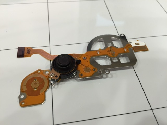

Pawel Gaul
p.3 #15 · joystick broke on a 5D Mark III
Hey Guys,
I'd like to revive this topic for people who never fixed their camera. Recently, I ended up replacing the toggle button myself and it was super easy. I had to buy the entire toggle button module that cost $100 at ebay and a set of small screwdrivers ( very small ones ) I thought I'd encourage others to do the same yourself and save money this way
Aug 31, 2015 at 03:32 PM
