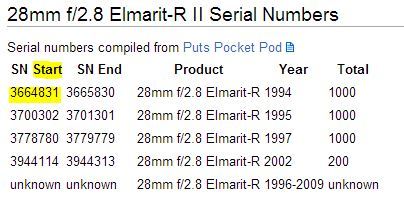

Lee Saxon
p.2 #2 · Leica 28/2.8 Elmarit-R versions

carstenw
p.2 #3 · Leica 28/2.8 Elmarit-R versions
Lee Saxon wrote:
This page lists only #11,333 (2nd optical version, built-in hood, ROM) under Elmarit-R II and incorrectly lists #11,259 (2nd optical version, built-in hood, 3-cam) under Elmarit-R I.
I fixed the Wiki page (I am a member over there, and cross-referenced the Puts Pocket Guide). Note that the number listed under the first version is 11529, not 11259. I don't find any information on 11529, so I left it for now.

Lee Saxon
p.2 #6 · Leica 28/2.8 Elmarit-R versions
I assumed 11,529 was simply a typo of 11,259.
For instance, the 3624801 to 3625300 batch is labeled 11,529. The lens from the OP, an 11,259, comes from that batch. (that should probably be moved to the v2 page, btw)

carstenw
p.2 #7 · Leica 28/2.8 Elmarit-R versions
I'll try to figure out who added that bit, and talk to them about sources.

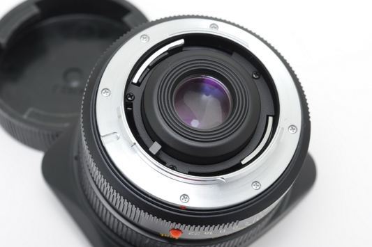

phuang3
p.2 #10 · Leica 28/2.8 Elmarit-R versions
Pictures of my copy. The version will clear the mirror of 5D2. Its rear shroud or retaining ring can be unscrewed simply by hand.
http://www.pbase.com/phuang3/image/109398993/original.jpg
http://www.pbase.com/phuang3/image/109398994/original.jpg
http://www.pbase.com/phuang3/image/109398995/original.jpg

kosmoskatten
p.2 #11 · Leica 28/2.8 Elmarit-R versions
That's the type of shroud that is in my former copy of said lens.

JaKo
p.2 #16 · Leica 28/2.8 Elmarit-R versions
Almass wrote:
If my memory is correct, only the 11333 ROM ones will not hit the mirror. Although the 11259 CAM ones have also the same fixed hood. All have the same optics.
To summarize, The Leica R Elmarit 28/2.8 Version II order number 11333 with ROM is the lens which will mount without hitting the mirror.
Lee's post below and serial numbers production batches may be a guidline to opt for lenses with SN number higher than the highlighted in order to avoid mirror clearance issue, at least on Nikon FF, but perhaps on Canon as well (dono much about Canon, but carstenw may be onto something regarding Canon samples variations)
Lee Saxon wrote:
Leitax page mentions that a customer with an early (3624xxx) 11,259 had mirror clearance problems on a FF Nikon but that later (366xxxx) 11,259's and 11,333's had no issue.
PS.
My recently obtained copy with serial number 3700xxx is a 1995 v2, E55 3-CAM version that clears mirror on D800 with no issues (pictured below)
Jan 11, 2013 at 11:11 AM
carstenw
p.2 #17 · Leica 28/2.8 Elmarit-R versions
Tim Davis, who has done the editing of the l-camera-forum pages, has confirmed the findings, and I have edited the pages to reflect what we have seen here.
