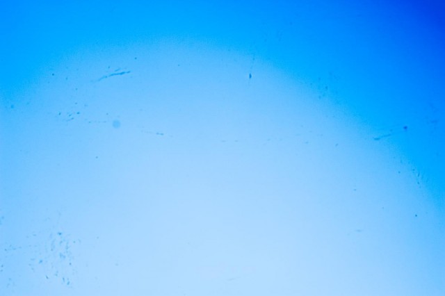

My D600 sensor was spotless, but a new D700 I bought a year or so ago came out of the box with the sensor looking like this:
Oct 21, 2012 at 10:15 AM

That one I'd return.

It is not "some part of it". And it is not (a bit) "dirty", the example looks like a mess! Just to remember some of you: The sensor is the most important piece of any camera.
If you buy a new car and you see it is full of cow shit, when I enter it, you would accept it and drive it home? I would not! This camera is a 2000$ piece of hardware. Imo a customer can expect that the sensor does not look like the above example. I would not purchase something like this even as "havy used" for half the price.
You all talk like cleaning is like doing some dishes. One can destroy the sensor (scratch it) by incorrect cleaning. One can clean as hell with no acceptable result, if this shown stuff is oil. Wouldn´t you return a 5$ book, if you find some shocolate fingerprints inside (of course not from yourself)? I would.
So more customers send back stuff like this, so earlier everybody will have the benefit of better QC in the future.

It looks like this thread has morphed into something larger but I wanted to report that I had the sensor cleaned and all is well now. The person cleaning noted that there was only dirt/dust on the sensor and not oil.
