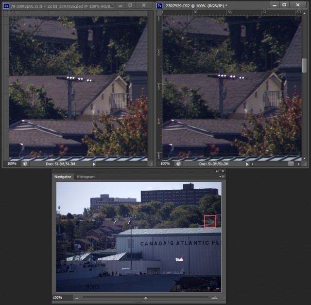

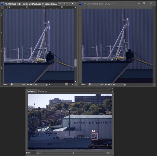

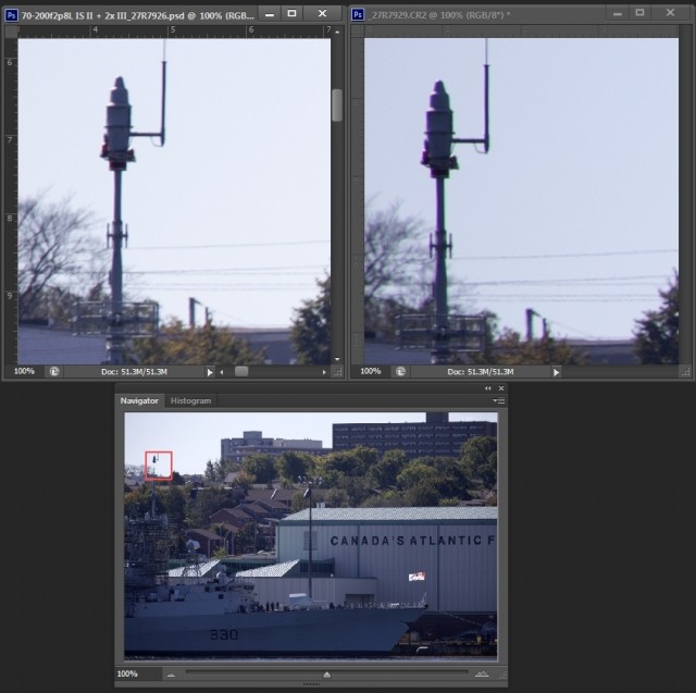

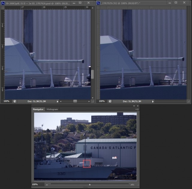

Sorry I just don't buy it. I have both lenses but would never use the 70-200 + 2x in place of the 100-400L in real life shooting, especially bif. Those top 100-400L shots don't impress me either. I think we are seeing atmospheric conditions level the playing field. Shooting across a lot of water and at tin roofs, where heat shimmer will soften the shots is not the best way to test the lenses. The dollar bill shots are more impressive, but they aren't moving. Let's see a comparison of keeper rates for action work.
I think of it more as if I have the 70-200 out and about I know I can get good IQ if I need to use the 1.4 and 2x TC's, but I wouldn't head out with this combo if I knew I was going to be needing 400mm for most of my shots.

jcolwell wrote:
In the current thread "Sigma 150-500 vs Sigma 50-500", I speculated that the 100-400L was slightly sharper at 400mm than the 70-200/2.8L IS II + 2x III Extender, see link below.
https://www.fredmiranda.com/forum/topic/1153892/1#11012537
My summary: the 100-400L is slightly sharper, although the 700-200II + 2xIII has less CA on bright edges. In the situation tested here, both produced fine images that could be used for just about any purpose, with minimal PP.
try taking a photo of an object 50 - 100 ft away - it's becomes even more obvious that the 100-400 is sharper

We are seeing atmospheric effects - that's one of the big challenges when comparing "real life" images. I could also compare lens resolution test chart images, but then many people would say that it's not relevant, because it's not "real life". The atmospheric effects did not change significantly during the three or so minutes required to take the comparison shots. The differences between the two in like conditions are real, although not large.
I agree that I wouldn't prefer to use the 70-200II + 2xIII over the 100-400L for shooting at 400mm, but that's exactly what I did in Utah for a month this summer. I didn't have room for both lenses, The 100-400L wouldn't be nearly as good as the 70-200II for the indoor events that I had lined up. OTOH, the 70-200II + 2xIII is nearly as good as the 100-400L, at 400mm. Easy choice for me.

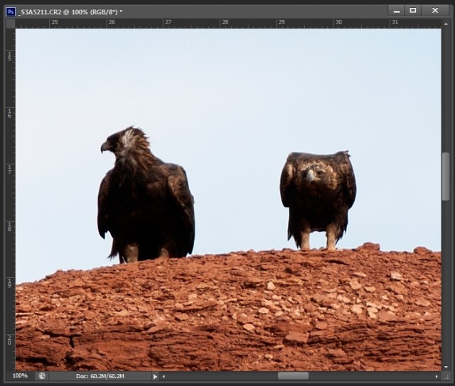

Here's a sample image taken with my 70-200/2.8L IS II + 2x III on 1DsIII, in Utah this summer. This was previously posted on one of Peter's threads (which was mentioned earlier, above).
Of course, some people will say that it's not a relevant example because there are obvious atmpheric effects. While others will say that it's a poor excample because I should never take an image at 400mm with a 1DsIII, when I also own a 1DIV. Of course, the 1DIV was 5,000 km away, at home with the 100-400L ...

What I take away from the comparison so far, is that the 100-400 has better contrast and sharpness, but higher CA than the 70-200+2X, but not a lot. If one owned the 70-200 and had to choose between buying the 2XIII or the 100-400, it seems simple to buy the 2X and save some money and space. But if one didn't need the faster 70-200, the 100-400 would be a better choice for 300-400 range in bright light.
I agree with Pixel, there are a lot of factors with the environmental effects, but that's common with longer focal lengths, and as you pointed out, near identical between the shots (although heat/moisture mirage may greatly affect shot-to-shot quality of certain areas). The only "solution" is more examples of different subjects and distances for a comprehensive base of information. Usually, that is a personal pursuit and not often shown in its detailing on forums.
More examples would be welcome and interesting, your time permitting.
BTW -- is that Halifax?
