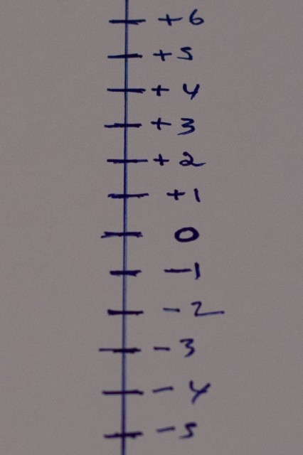

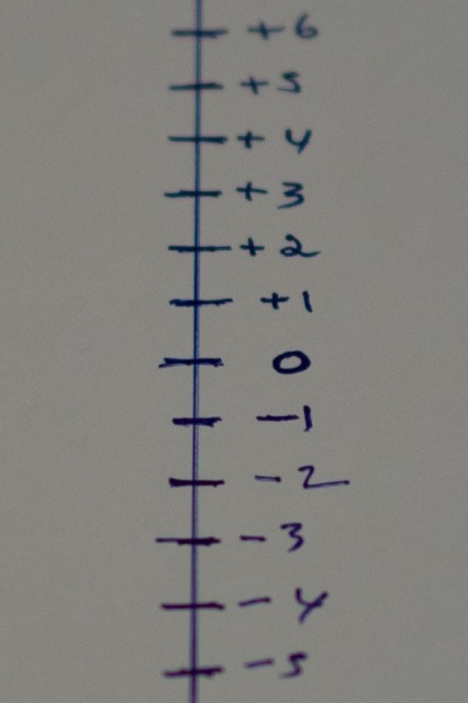

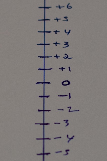

Ok, quick and dirty test. MFD on tripod. Focused at f/2 with magnified view, then took 2 other shots at 2.8 and 4 without changing the focus. Here are 100% crops:
NB: The increments are 1 cm approximately.
F/2
F/2.8
F/4
Edited on Jul 07, 2012 at 06:31 AM · View previous versions

I guess the conclusions would be:
1. The 35/2 does have focus shift.
2. It is somewhat negligible because the point of focus remains sharp.
3. The direction of focus shift is backwards consistently with other lenses known to have this problem.
Jul 07, 2012 at 06:27 AM

p.2 #4 · Zeiss ZM Biogon 35/2 or C-Biogon 35/2.8?
Interesting. It seems different than i thought, since I no longer have the test picture, I will do another test with my m9 to confirm.
But, I am not sure #2 is valid depend on the lens. If your copy optimized at f2.8/f4 like I have on my M9, then f2 wil be front focus, it is not negligible at this DOF. If your copy optimized at f2, then I would say yes
