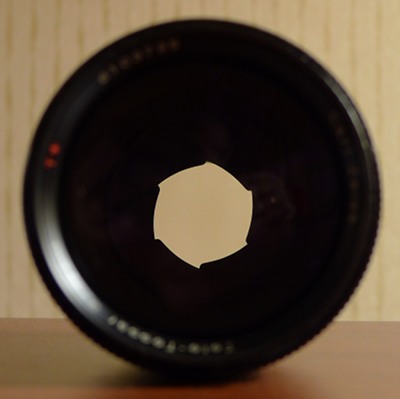

Samuli Vahonen
p.1 #14 · p.1 #14 · Contax 135mm Sonnar T*
debuggerus wrote:
Svenning,
If you could get a MM version, I think it would be a little better. The AE has 'ninja star' shaped aperture around f2-f2.8.
Some people also prefer ninja-star aperture. I find the bokeh very pleasing at f/4 where aperture is shaped like this:
Feb 21, 2010 at 03:45 AM
