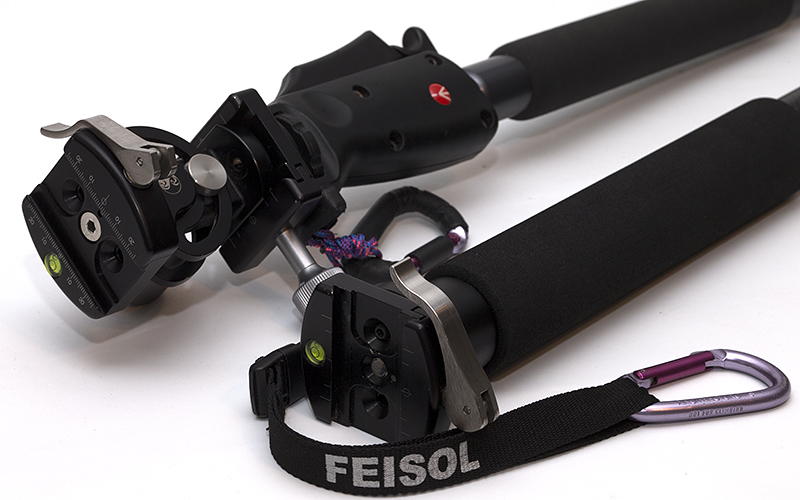

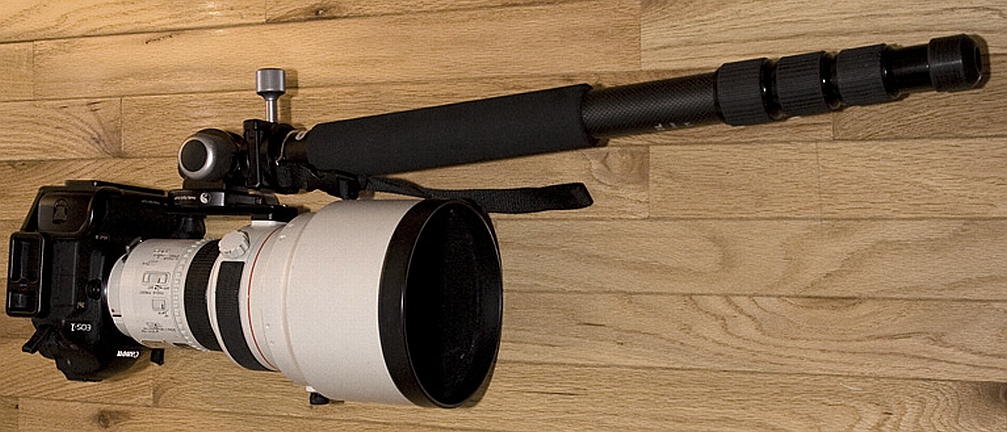

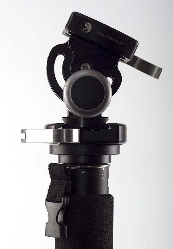

Yes, monopod. No, ball head. Yes, heavy-duty tilt head.
I use my EF 500/4L IS with a RRS MH-01 monopod head (A-S clamps & rails), on one of two monopods; (1) Manfrotto Neo-Tec, or (2) Feisol CM-1471 Rapid. I use the Feisol for travel, as the Manfrotto is long and heavy, but its one-handed action can't be beat in close quarters, like on the sidelines or in a theater.
My MH-01 monopod tilt head has an A-S QR lever-clamp on top (for the lens), and an A-S plate on the bottom (to clamp on the monopod). Both of my monopods have an A-S QR clamp on top, and so it's easy to share the head. When shooting fast action, I can go from shooting on the monopod, to shooting handheld, in a matter of seconds.

MH-01 on Feisol
© jcolwell 2004-2024
(bkgd) MH-01 on Neo-Tec, (foregnd) A-S clamp at top of Feisol

300mm f/2.8 on MH-01 + Feisol, head tilted to carry position
