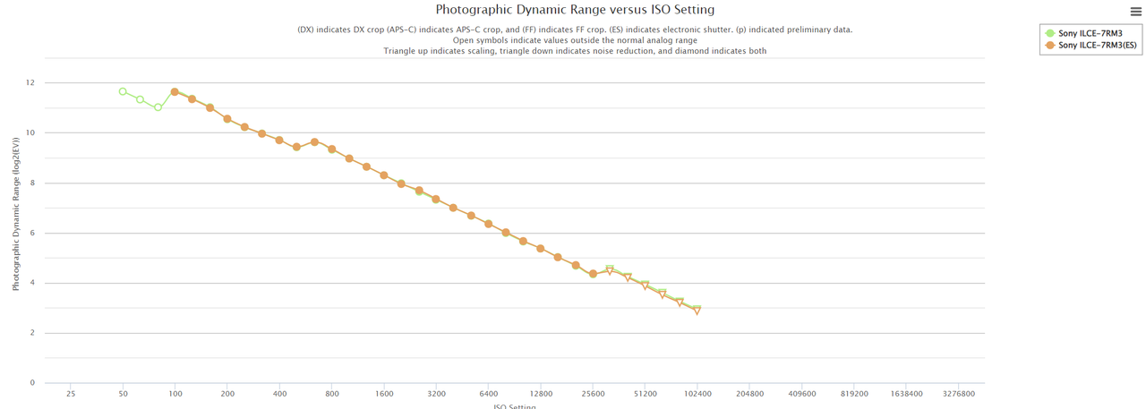

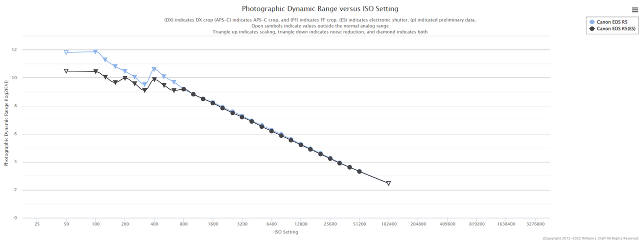

R5 is NOT dual gain sensor... it just Canon's tricks with forced NR applied @ nominal ISO values <= 800... compare MS vs ES where Canon's can't hide the fact
https://www.photonstophotos.net/Charts/PDR.htm#Canon%20EOS%20R5,Canon%20EOS%20R5(ES)
usual classic Canon's see-saw which Canon makes look like a proper Sony dual gain sensor using NR
here is a real dual gain = MS or ES - same sh$t ... no NR detected
https://www.photonstophotos.net/Charts/PDR.htm#Sony%20ILCE-7RM3,Sony%20ILCE-7RM3(ES)
