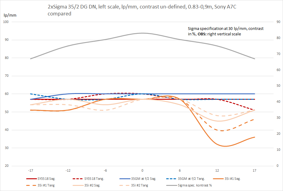

Sometimes it gets too bad though. I have owned the Summilux-M 35/1.4 ASPH (pre-FLE). Great lens as I got many beatiful images - but it couldn't make an image sharp from the left to right when needed. Another example is the Sigma 35i. I had no luck with that lens. Here is cluttered comparison between sample 1 and 2 of the 3 different copies I tried thinking one shouldn't give up.
So, OK, I gave up. Maybe I should have made another attempt later as i noticed the three copies (bought from three different stores) all were pretty close to each other if comparing serial numbers. The point however, even if not very critical about even performance from corner to corner midzone dips sometimes can be too much.
