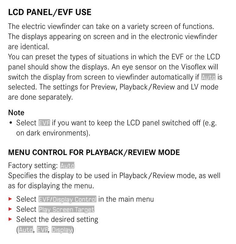

You can write to Leica and request this option. Maybe some day it’ll come to the M. Useless for me since I don’t use EVFs. Which is the whole reason I shoot a rangefinder. Rangefinders aren’t the best tools for a great EVF experience.

https://i.postimg.cc/PJnbn87B/IMG-4179.jpg

Are you sure that menu is for the M11? I cannot find a Menu with those selections in it.
My Display Setting Menu only offers:
LCD BRightness
EVF <> LCD
Eye Sensor Sensitivity
EVF Brightness
The EVF <> LCD SubMenu only offers:
LCD
Auto
EVF EXtended
EVF
None of those has a SubMenu.
Edit:
OK I figured it out.
If I set my Display Settings to EVF EXtended I get pretty much what I wanted.

That’s the M10R manual. The M11 also has a manual. I’m sure it’s in there. Just saying; read the manual. Seems like nobody ever does.
