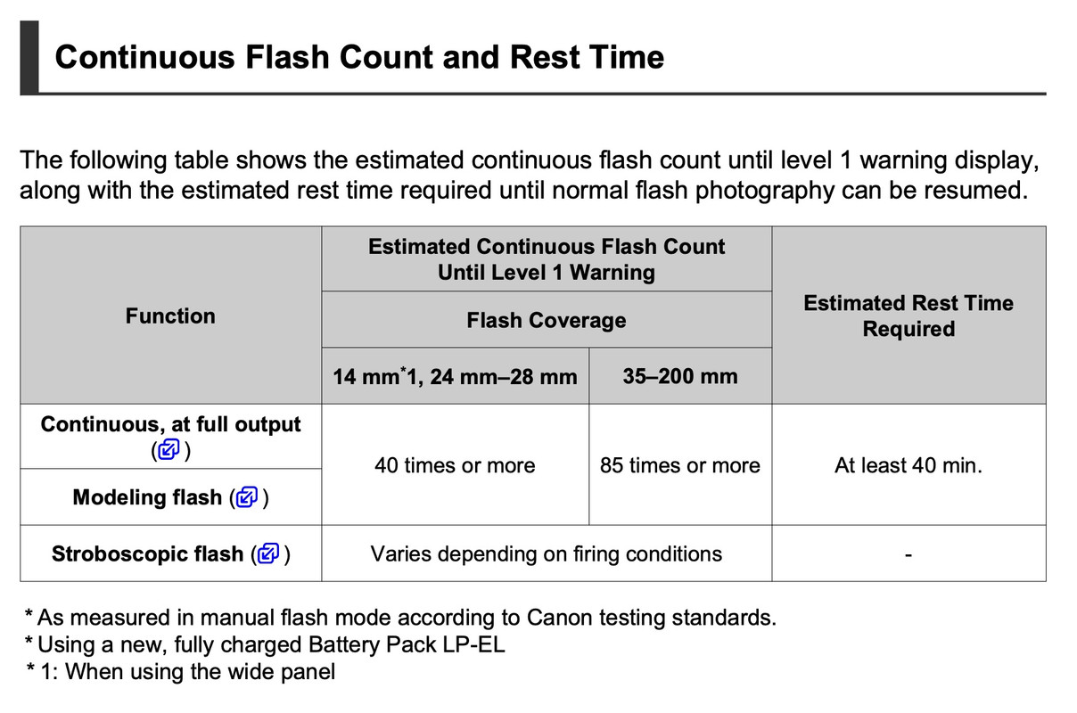

Found this in the manual
Precautions on continuous flash firing
To avoid wearing out or damaging flash heads from overheating, do not fire the flash continuously at full output more than approx. 40 times. After firing continuously at full output this many times, stop using the Speedlite for at least 40 min. After continuous firing at full output this many times, further continuous firing at short intervals may activate a safety function that restricts firing. At a firing restriction level of 1, the firing interval is automatically set to approx. 8 sec. In this case, stop using the Speedlite for at least 40 min.

Pg. 173 of the manual or this link to the HTML version:
Repeated use of continuous, stroboscopic, or modeling flash at short intervals may increase the temperature of the flash head, battery, and areas near the battery compartment.
Repeated flash firing gradually increases the firing interval, up to approx. 4 sec., to avoid wearing out or damaging the flash head from overheating. Continuing to fire in this state will automatically restrict flash firing.
Note that when flash firing is restricted, a high-temperature warning icon is displayed, and the flash photography firing interval is automatically set to approx. 8 or 20 sec. (levels 1 and 2, respectively).
