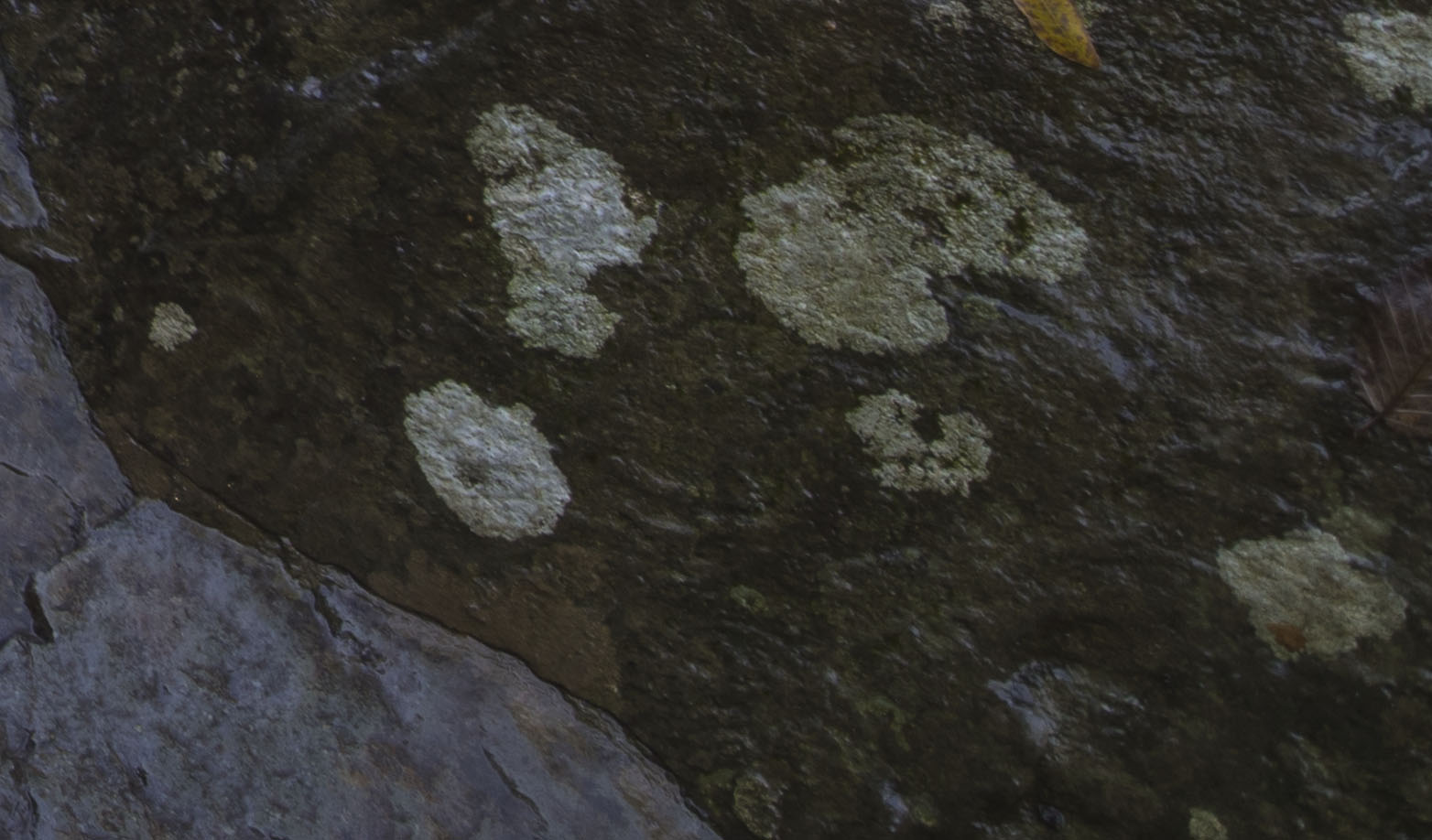

Perhaps I have a better copy of a WATE than those reported by Bastian and Fred. I believe that I have a good copy, but I am not sure it is totally centered as I never tested the lens as closely as Fred, and this may not be quite what Fred has commented about for the performance of the lens. Yes the lens is supposed to have the the best performance at 16mm and weakest at 21mm. But, I have found good performance for the lens at f8 at 21mm.
Below are an image taken of Dark Hollow Falls, Shenandoah, NP at 18mm, ISO 50, lens set to f8 for 1/5 second and tripod mounted with my stock A7r camera taken October 19, 2015. The image has been processed in Lightroom, but with what I have learned since, could improve the output with the newest form of Lightroom and its tools. The first image is the full frame and the others are images at 100% near center and other points and the 4 corners of the image.
Be aware, that the WATE performs even better on my Kolari Vision Ultra Thin Sensor modified A7rII camera.
Another option to possibly consider the Laowa 20mm f4 Shift lens in different mounts that splits the difference between the Canon 17mm and 24mm lenses. I know that Bastian has his feeling regarding the lens and would suggest even a wider angle lens like the Laowa 9mm lens and not bother with a shift or tilt/shift lens. My copy of the lens is in the Canon EF mount that I can share on my Cambo Actus Mini camera with my Sony bodies and with an adapter can use directly on my Sony bodies.
