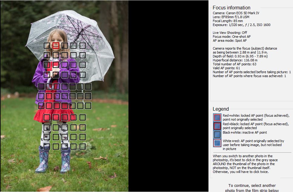

lighthound wrote:
Something is very odd here for sure. I was going to suggest it's your lens and not the body but you have stated that it's showing up on all your lenses so it has to be your body.
And it's definitely not a AFMA issue as you and others have stated. The one of the little guy next to the water is so far off, no AFMA correction could fix that.
Take a close look at the little girl image. Her boots and stockings are sharp which should be pretty close to the same focal plane as her face, yet her face
...Show more
Dave - Yes, something is definitely weird in the shot of my daughter. I was a little stumped on this one as well as her stockings are clearly in focus and as you point out that appears to be in about the same plane as her face. But it's strange the umbrella behind her is sharper than her face. Maybe this was a bad example, as I cannot completely rule out that she moved a bit. I'll look for some other examples.
I agree with you that if there is an issue with the body and/or lenses there's no point holding off on sending them in. I think lately I've been holding off more because I don't want to go through the effort and expense of doing that only to have Canon tell me there's no issue and send me a bill for their time.

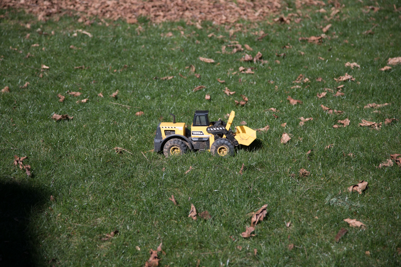

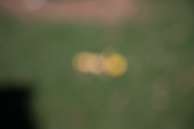

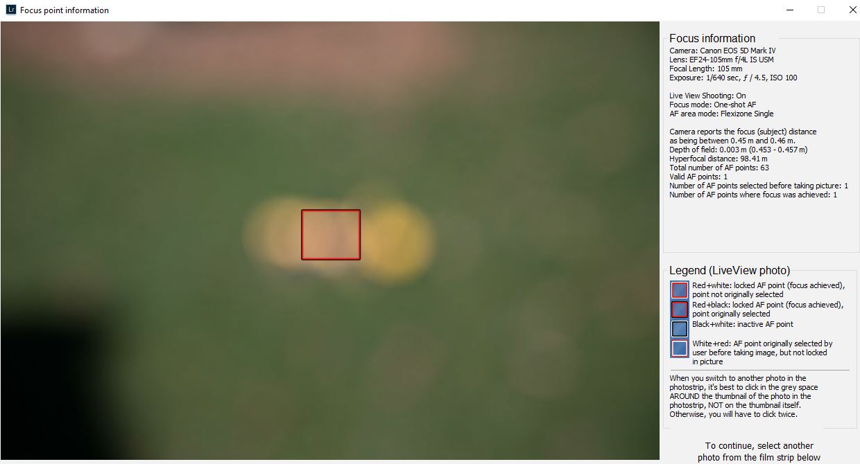

I had to set this aside for a little while, but back at it now. I'm pulling together all the info and photo evidence to send to Canon to show the issue. Today I took a bunch of test shots with various lenses, focal lengths, live view on/off, tripod mounted with cable release, etc.
I will be sending the body to Canon for service. Just trying to figure out how many lenses to send. I'm thinking the 24-105 for sure. I've seen focus issues on other lenses as well, just can't decide if its worth sending them all in since it seems to be an issue with the body.
The things I noticed today are:
1. I achieved better focus in live view most of the time (see 3 and 4 below for when I didn't get better results).
2. Viewfinder AF was pretty consistently slightly front focused, and didn't look as good as viewfinder AF. But, my micro adjust is set at -2 on a couple of the lenses I was using. Maybe it should be back to 0. Didn't test that yet.
3. At one point with my 24-105 mounted, and at 105mm in LV, the camera consistently "achieved focus" (box turned green) and shot the picture with the image totally out of focus. Samples below. It did this when I set the lens to closest focus before pressing the shutter button halfway on the cable release. Every time. It didn't even attempt to focus. At infinity, it focused fine.
4. After testing a couple different lenses, I went back to the 24-105 to try out what happened previously (#3 above). This time, when set to closest focus, and pressing the release half way it did not attempt to focus at all, and the box stayed red indicating no focus. It would not take the picture.
Here is what I was using as my test scene:
Here is what I was constantly getting as described in #3 above.
And here are the settings, and the focus point showing it achieved focus, but clearly didn't.
On a different note, I was seeing some pretty big jumps in white balance when I turned on live view. I don't know if that is normal. I don't use live view often, so never noticed. But jumps of around 1000 K white balance switching live view on/off, photos taken within seconds of each other under same conditions (full sun). Probably totally unrelated to my focus issue, just an observation.
