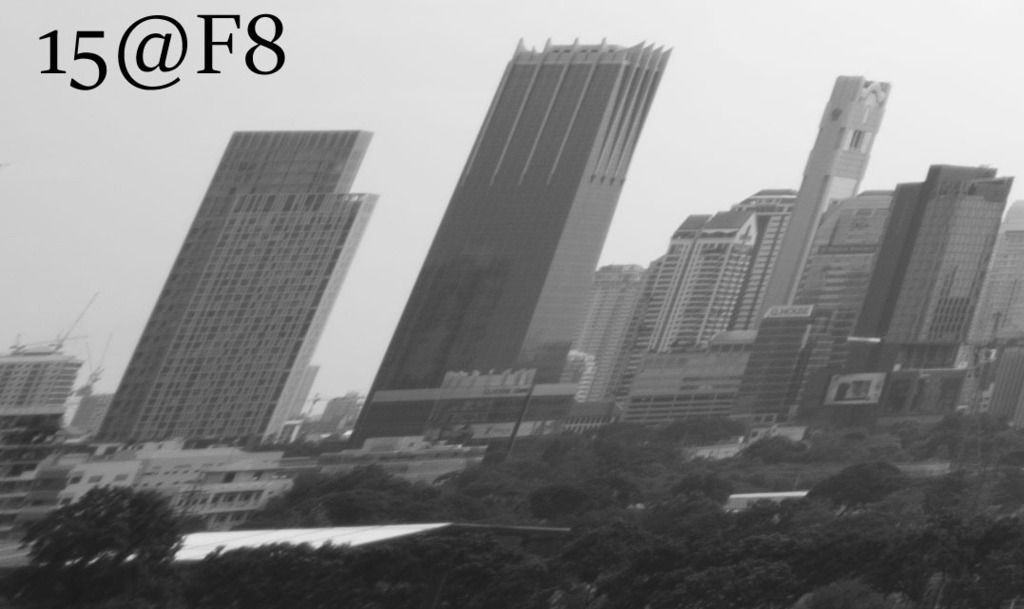

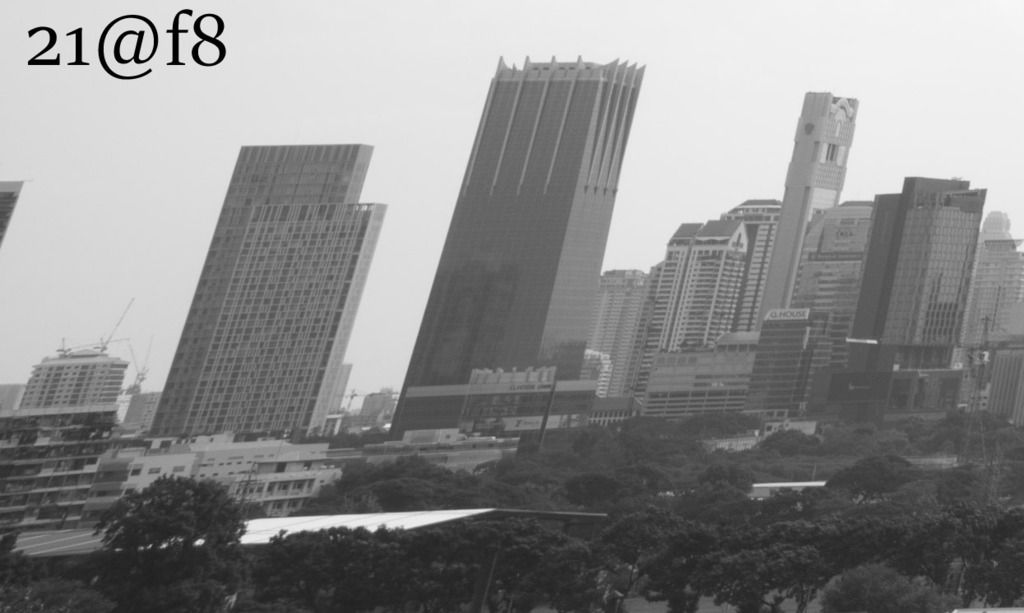

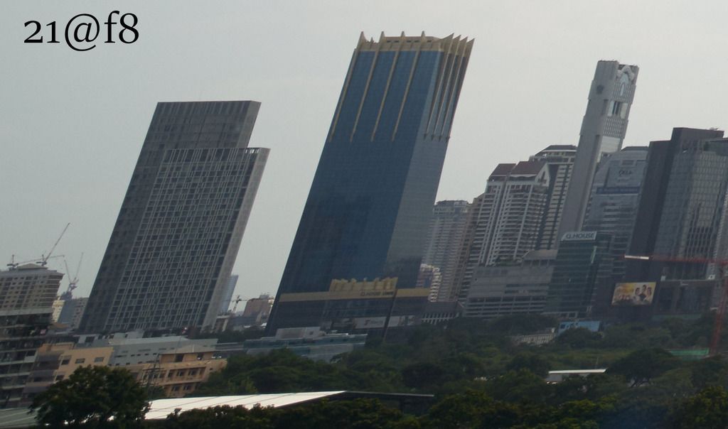

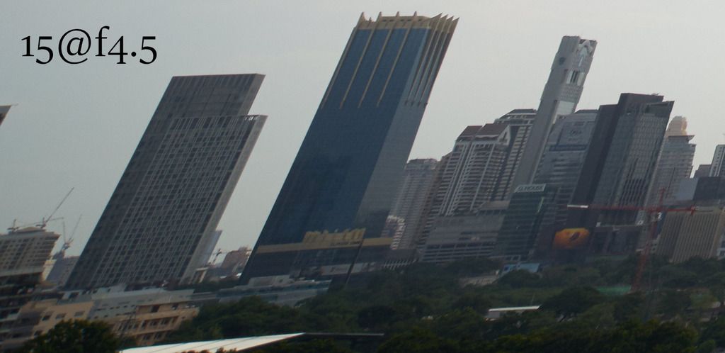

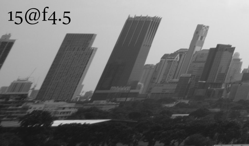

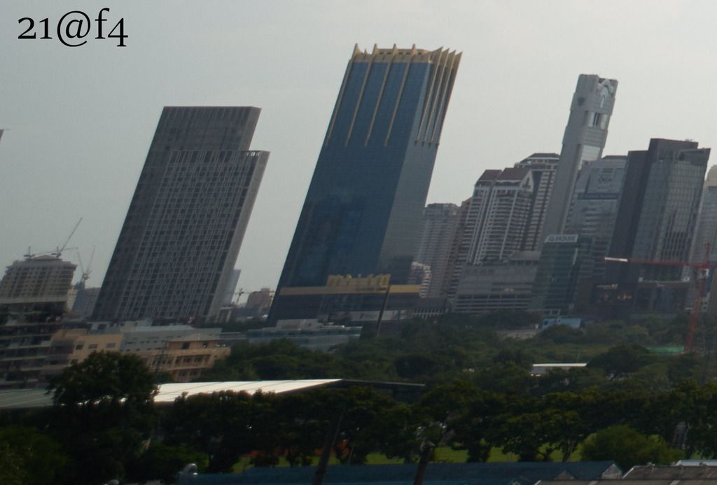

hmmm, on my computer, it is all shown at the same size but in reality MM cropped is about 1200x700 while A7r ii is 1500x900 so if blow up to the same size, A7r ii certainly would have some benefit. However, viewing on my computer at 100%, I think they are very close, I might be convinced either way, may be a slight edge to A7r ii.
I am not sure why at 16mm, there seems to be less vertical distortion on A7r ii though. At 21mm, they are pretty close.
I focus at a building in the center of the frame but it is on a street that all the building including the one of the edge is on. I did take a peak at the edge to make sure it is not badly out of focus but the focus is set at the another building along the same plane for both Sony and Leica.
And just for the heck of it, I throw in CV 15/4.5 iii as well. I think this new version is really optimized for Sony though so the result is not surprising.
Unfortunately it is not a Leica killer eventhough it is optimized for Sony rather than Leica (at least the corner sharpness anyhow)
Edited on Aug 12, 2015 at 04:58 AM · View previous versions

Thank you for this and very interesting to see on a Leica, it's actually softer. However, I think this CV 15III is a tad sharper than the WATE at 16, at least around f/4. Do you have an f/8 picture? One day I have to rent one to test it against my ZM 15.
