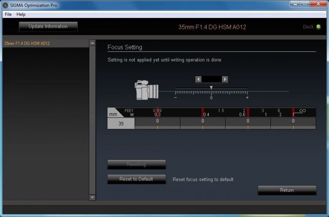

Here's a screenshot with my lens attached, and as we all assumed, the numbers are zeroed out. Why wouldn't they be? Ever buy a new camera with the global MFA setting to, say +7, straight from the factory? That'd be silly.
I can guarantee (because I have built complex things in both Japanese and Chinese factories) that each lens receives final calibration on an automated jig. A worker places it in the fixture and pushes a button, the rest is automatic. The fact that the default user settings are all zeros confirms my prediction that there is a shadow set of register used to hold the factory calibration numbers. I hope we can now agree on this point.
Sigma's "very best" therefore is simply a well designed calibration fixture whose only job is to dump four numbers into the shadow registers. My only expectation, and I don't think it is unreasonable, is that they are at least as competent as their users when selecting the base numbers.

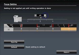

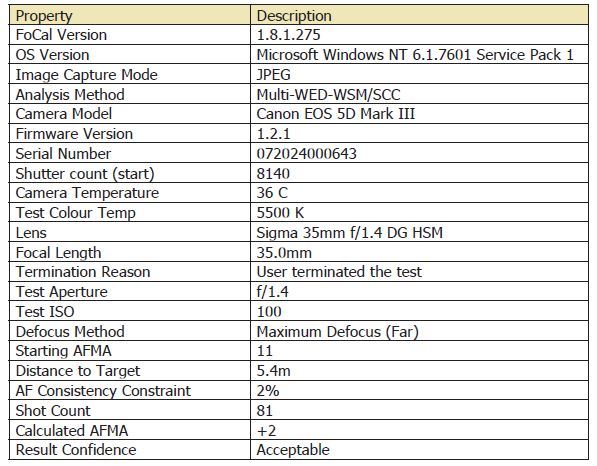

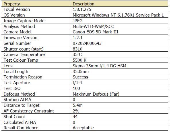

So I received my dock today to try with my 35mm lens. Focal has a recommendation for the lens of +13 on my 5D III and it looks pretty sharp at 1.4 with that setting. I put the lens on the dock and it updated the firmware then showed me the lens settings were 0 for all 4 distances. I set them to +13 on the lens for all 4 distances and retested with Focal. Here is a chart of what it took to get to 0 MFA on the body.
Body Lens Focal
+13 0 +13
0 +13 -5
0 +8 -1
0 +7 0
So it appears any changes to the lens settings are about 2x what a MFA adjustment on the body is. So a good starting point to set the lens to would be one half what the body MFA setting currently is.
