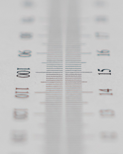

denoir
p.3 #3 · p.3 #3 · Zeiss 35mm F2 vs Samyang 35mm F1.4
Yes, perhaps you should read that document. Green edges around highlights are a textbook example of LoCA.

denoir
p.3 #7 · p.3 #7 · Zeiss 35mm F2 vs Samyang 35mm F1.4
Tariq Gibran wrote:
Color fringing in the oof transitional edges is what bothers me about LoCA and I don't see it. I do see it in the oof areas in a few of your shots. The last one taken with the Rollei shows some pretty severe cyan eges to the white bokeh at the far right corner and what looks like green as well towards the center. 100 percent, uncorrected crops would show this pretty clearly I bet. Even the previous glass shot and the potted roses with the 35 F2 shows some blue tinge in the white which is likely LoCA,
...Show more
The Rollei 35/1.4 Distagon shows indeed plenty of LoCA, but the 35/2 is a different story with much better LoCA control. The down side is that it produces a rather dull, neutral bokeh which may or may not suit your taste.

denoir
p.3 #10 · p.3 #10 · Zeiss 35mm F2 vs Samyang 35mm F1.4
Sp12 wrote:
Green rings around the highlights have almost nothing to do with a CA correction, and everything do with SA correction. Page 37-39 of that PDF can fill you in with the details. Green rings (spherochromaticism) is definitely not a CA effect (well, 90% not a CA effect). Even APO glass can have it. It's a SA effect. We can definitely agree it's one of the worst points on the Samyang 35.
It's not spherochromatism that we're seeing.
Here's a simple example of the difference:
http://peltarion.eu/img/comp/color/loca.jpg
The 100 MP is highly corrected for SA while the 85 Planar is not. If you see only a green edge then it's LoCA. If you see a degradation of contrast and a general smearing then it's SA (spherochromaticism).

If you look at Lenstip, they seem to show the same thing.
http://www.lenstip.com/upload3/2641_aberracja_15.jpg
http://www.lenstip.com/upload2/15302_zei35_abISO.jpg
Lateral chromatic aberration, the issue at hand here, is independent of the aperture but at large lens openings it may be obscured by other aberrations. As the lens is stopped down, these other aberrations are cured and LCA becomes more clearly visible. Not because there is more LCA, but because other blur mechanisms are taken away. A problem with these sites is that they don't seem to know what they are doing. They do not measure chromatic aberration, but apparent color fringing. A subtle but important difference.
