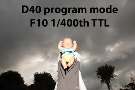

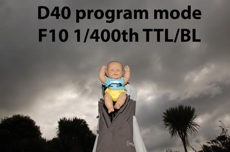

With regard to your follow on post of the plate and Stinky outdoors under the overcast sky, the differences in exposure has to do with how Nikon configured Standard TTL and the various automatic balance fill flash modes. Standard TTL mode uses only the info from the TTL flash sensor(s) (some Nikon digital cameras have a single TTL flash sensor while others have two) while the automatic balance fill flash modes use the info from the TTL flash sensor(s) and the camera's TTL meter. Standard TTL keeps the camera's TTL metering system separate so that the user may gain greater control of exposure if they choose. The TTL shot of the plate was underexposed because the TTL flash sensor (and no doubt the center segment of the Matrix meter) saw the predominate white of the plate. Seeing alot of brightness it held back the flash exposure, rendering the scene under exposed. The TTL/BL shot included the camera's TTL metering and rendered the scene more accurately. The TTL/BL shot is a classic example of Nikon's CLS working as advertised. In the shots of Stinky under the overcast sky, the shot using TTL was clearly impacted by the Matrix meter's outer four segments seeing mostly sky. The end result was the camera's TTL flash sensor (working alone in TTL flash) was fooled into thinking more flash was required than was necessary. Those outer four segments of the Matrix meter completely over ruled the center segment and the subject was given too much flash exposure. In contrast, the TTL/BL shot included the camera's TTL meter in the scene evaluation and once again TTL/BL got the shot.
There's much more at play here than just focus/defocus info. Brightness and contrast will also be considered by the system, to the extent than one or more of the three variables will be given more weight in each unique scene.

The picture outdoors with bright back-lighting is what TTL/BackLit was originally designed for but now as you can see it works indoors as well and that is no longer the sole purpose of the new TTL/BL[ Balanced Fill Flash ] - you need to forget about "BL" meaning 'Back-Lit' unless you're shooting with a D100 - technology has moved on .
