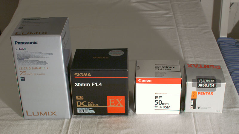

Jonas B
p.1 #8 · Leica D Summilux 25 mm f/1.4 review
Makten wrote:
I wonder how many pages it will take this time.
Heh. "Equivalence" questions seem to be forever confusing.
On another aspect I also wonder how many posts about the lens there will be by people not having used it?
The smaller the sensor, the bigger the... box!?
Cheers, /Jonas
