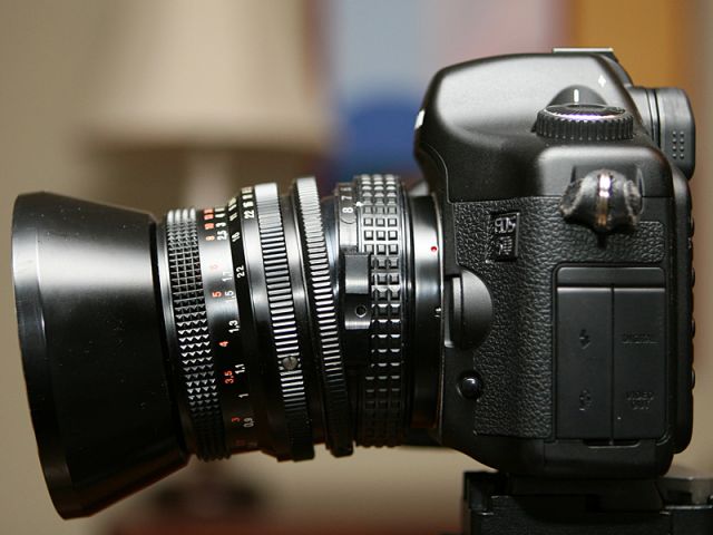

I've just picked up a Pentacon 6 to EOS tilt adapter, and a Mamiya 645 to EOS shift adapter, both from eBay. I'm in the process of converting the Pentacon 6 (P6) to accept Hasselblad C 500-series lenses (HC), and I also have a HC to M645 adapter on the way. I have a Mamiya 645 35/3.5 lens that will get used on the shift adapter for perspective control, and a few P6 and HC lenses that will fit on both the shift and tilt adapters, although I think the tilt will be most valuable for normal and short telephotos. I''ve been too busy travelling and working on my full time job to do anything more than a bit of playing with this new gear, so I hope to make real progress through the fall.
No, I don't have GAS - honest, at least not if you accept my logic. I lost the tilt/shift capability when I sold my LF gear, and I want it back for: (i) perspective control for 35mm and 50mm architecture photos (wider would be nice, but you can't get a wider rectilinear MF lens); and, (ii) plane of focus tilt for "product" photos with normal and short tele lenses (the wider angle lenses have sufficient DOF so that tilt is not so important). I figure the larger image circles of the MF lenses will avoid shift vignetting, plus I can buy a handful of these lenses for less than a pro 35mm T&S lens. Of course, many of the MF lenses don't have resolution as good as the really good 35mm lenses, but I have high hopes for the Hasselblad Planar 80/2.8, so I will be most interested to see if it has much CA when tilted. I'l also compare my M645 35/3.5 (and perhaps a Pentax 645-A 35/3.5) and the Zeiss Jena P6 50mm & 80mm lenses with some of the 35mm competition.
Here's a photo of a Pentacon 6 Carl Zeiss Jena Flektogon MC 50mm f/4 on an EOS 5D, with a Pentacon 6 to EOS Tilt adapter from eBay member sellbuyown1959 (no relation to me), tilted to the max. angle of 8 degrees; in this case, it's tilted down.

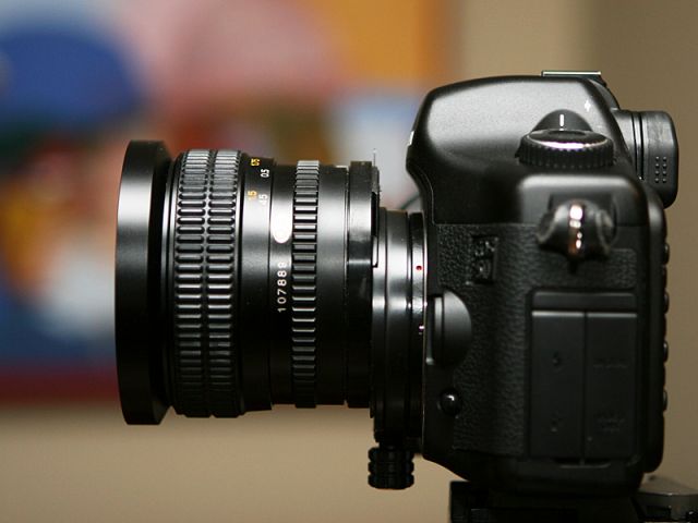

...and here's a Mamiya 645 35mm f/3.5 on an EOS 5D, with a shift adapter from eBay member grizzly33bear (no relation to me), shifted to the max. of 11mm; in this case, it's shifted up. This is the first time I've mounted this shift adapter (it arrived this past week while I was away), so I'm a bit peeved to find that the shift knob won't quite fit under the finder bulge of the 5D, but it does fit (just barely) on the 30D. OTOH, when shifting upwards (knob at the bottom), the 5D can use the full 11mm of shift, but the lens lockpin release spring hits the flash overhang on the 30D, so you can only use about 9mm of up shift - go figure!
Both the tilt and shift adapters are a bit of a pain to mount and especially dismount, as there is only a slender inner-ring that is connected to the EOS (or EF) mount itself; the next ring out rotates freely to allow you to change the direction of tilt or shift. So, you have to grip this slender inner-most ring to rotate the adapter when putting it on and taking it off the camera. Oh well, only time and photography will tell if this is a worthwhile way to go for me.
