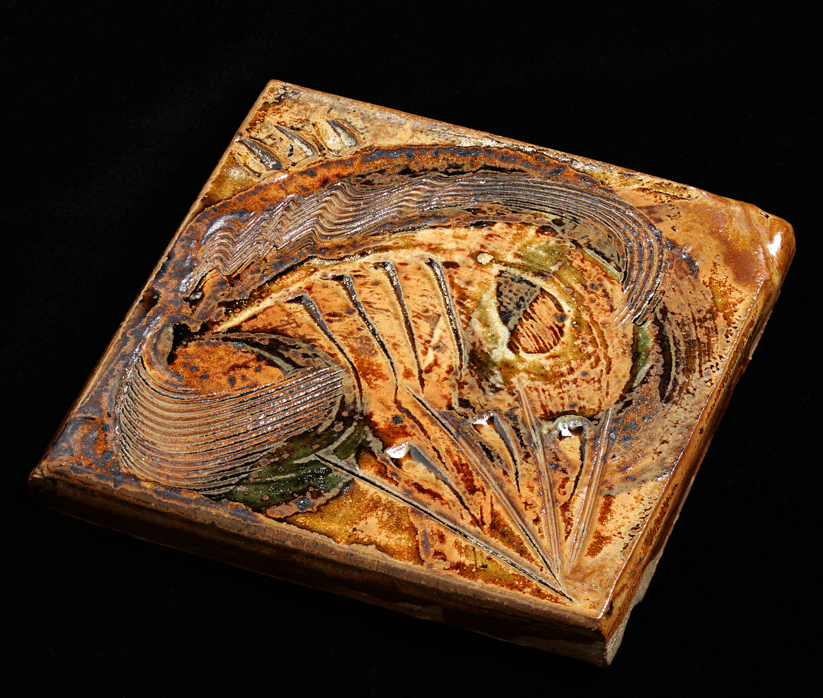

@mirrels, Being released with the PB-4, the Bellows-Nikkor should have a sufficient image circle, but I don't know personally. For sure, the CZ equivalent (S-Planar 100/4) covers the 645 frame, as fully utilized here:
In general, I would be suspicious of bellows lenses from 35mm systems since the larger image circle is an expensive feature. Many such lenses (like the Leica R 100/4) were offered for macro purposes, not T/S.
