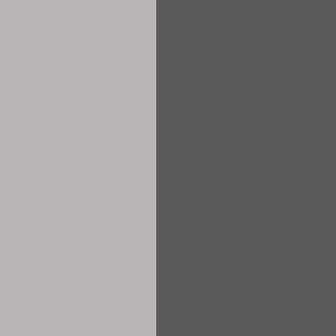

First it helps to understand how USM works psychologically and technically. Psychologically sharpening is an optical illusion. Technically it is created by detecting borders between contrasting tones/colors and increasing the contrast at the border. By way of analogy it's like creating a stone wall along a property line. The three controls in the basic USM function control the characteristic of the "wall":
Amount = Amplitude (how much contrast is changed)
Radius = Width (how far on each side the contrast is applied)
Threshold = When to apply it (How much difference there needs to be between tones).
This is a screen shot of a tone border enlarged 800% in Photoshop created by hand (not in a photo):
http://super.nova.org/XP/Photoshop/PS_USM/USM01.jpg
Here it is with (500, .2, 0) USM applied:
http://super.nova.org/XP/Photoshop/PS_USM/USM02.jpg
As you can see USM alters the contrast at the borders. If you get up and walk across the room the eyes will not resolve the differences in contrast but it should seem sharper.

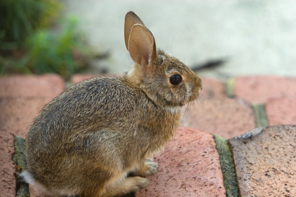

Reproduction of fur and feathers is also an interesting study in lighting and USM. Both have tiny mirror-like facets which catch light and create sparkle in direct collimated light. It's the sparkle off the individual hard hair shafts that create the illusion of soft 3D texture of the overall body. But the combination of RGB senor processing and AA filter turn those specular shape clues into mush at capture and the illusion of 3D is lost. Using diffuse lighting (overcast day) makes matters worse because diffuse light doesn't create sharp specular reflections. As a result in a photo a dog whose coat sparkles when seen by eye will look dull and matted in the photo due to the lack of specular clues.
Taking a page from Sargent's playbook what I do with animal photos is selectively over sharped the fur to the point where the halos create on borders when over sharpened create the same illusion of 3D texture seen by eye from the real specular highlights. This visitor to my front porch on an overcast day is an example of that technique:
No USM:
http://super.nova.org/XP/Lighting_FurFeathers/Bunny_NoUSM.jpg
(500, .2, 0) USM:
http://super.nova.org/XP/Lighting_FurFeathers/Bunny_StdUSM.jpg
Second (500, .5. 0) USM layer selectively applied with masking:
http://super.nova.org/XP/Lighting_FurFeathers/Bunny_StdUSMPlus.jpg
