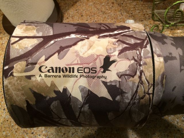

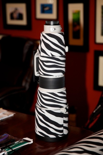

Or you can do what I do. Make your own.
Al
ps. No problem cutting neoprene. If you do make a mistake, contact cement works great as a repair.

First try Rockywoods, Seattle fabrics or Google neoprene camo. Hot melt glue is not long lasting or strong enough. I even tried my commercial hot melt urethane glue gun. The best method is Formica Brand, Wellwood or similar contact cement.
It's simple. Measure and cut. Then coat both edges with two coats contact cement. Let dry to the touch. Then join both edges. Be careful. Once you join both edges they will not come apart. I suggest one or two trial runs. After that you'll be a pro. You won't need Lenscoat or their bad customer service again and you'll do it your way.
Good Luck
Al

Forgot to mention something. Go on UTube. There's a video showing how Lenscoat made a cover for the Canon 1200. It will really help when it comes to technique and methodology.
Before you know it, you'll be wearing camo underwear.
Seriously. I have made covers for friends and relatives. I enjoy doing it. Anything Lenscoat can make, I can replicate.

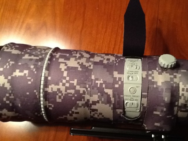

Personally the 3mm is more playable and movable. I've learned by trial and error that a snug fit is better. On my big lenses I use a double sided tape. It's actually golf grip tape which I prefer because it's very thin. When it came time to sell a lens the tape came right off and cleaned up very easily.
I found that once the cover was complete, I did not have to constantly readjust it.
Al

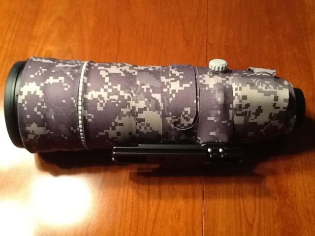

I made my own too with 3mm neoprene from Rockywoods. I also got the cement that they recommended on their site. I learned the same way that snug is better. If they aren't snug enough, just cut some material out along the seam and re-glue.
The first few pieces I glued and sewed but once I saw how strong the glue was, I didn't bother with the sewing.
