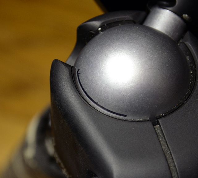

I really kind of doubt it. but then there is a simple test for "ball settling".
you take a sharpie and run a line along the edge of the cup on the ball and then do your thing. if it doesn't move you better start looking elsewhere and you most likely will have too. most people when they set up their stuff hold things from below upwards. you tend to unload more then you think in just a small amounts and that people think is ball settling. the ball doesn't settle its locked in a cup. everything else is free to move. when you let go you unload the entire assy not just one little thing on it.
