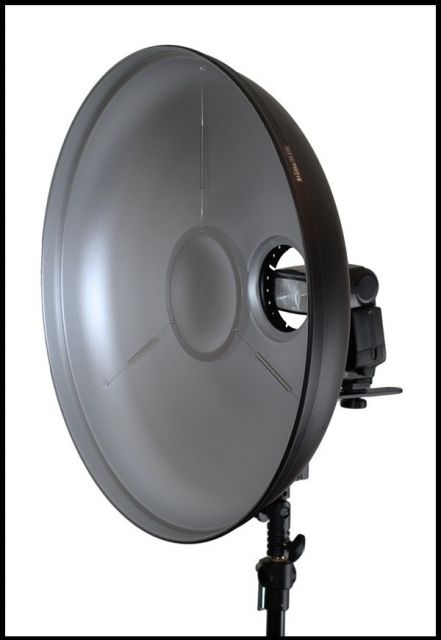

As for beauty dishes, there are models designed for Speedlights/Speedlites; I use one myself, along with smaller dish reflectors and soft boxes.

If your primary concern is having enough power with speedlights, Lastolite has a series of modifiers that can hold up to 4 of them. Some people use the considerably less expensive (< $200) Yongnuo speedlights (YN-568 EX) in place of Nikon SB-910's. The Nikon version of the 568EX supports iTTL, but unlike the SB-910, it can't be used as a Master in a CLS environment. If you like the bare-bulb concept and can live with pure manual mode, Cheetah Stand is very close to releasing a fairly powerful CL-360. I have one of their CL-180's, and it has worked flawlessly.
