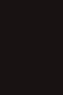

+1 @ Brian's point at your face ... i.e. your key lighting on your face is not properly (i.e. over) exposed, while the key lighting on your bottle is. The majority of your scene (background/shadow areas) is not illuminated by your key light ... i.e. low usage (area of scene) of key lighting produces low key, not to be confused with underexposing your key lighting. Other than the facial exposure issue, I'd say you've pretty well got the gist of it.
Here's the average of your scene (24,19,18), definitely in the lower quarter overall.

Thank you RustyBug for further clarification. I'm not sure, however, that I could have increased exposure on my face without overexposing the bottle. I used one strobe w/ beauty dish which was to my right and slightly in front. I shot this in my 10x10 dorm room...very cramped space to say the least, not to mention the difficulty of shooting oneself.
Just curious, how did you average the scene? Browser ext, app, software, etc?

Kevin,
Yeah, I figured that you were using a single strobe and had to choose between exposure @ near object (face) vs. distant object (bottle). Since exposure is related to distance from source, this is where you'd either need to use two different light sources, make the objects more equitable in distance or partially block/reduce the portion @ nearest object (face), etc.
Average the scene ... Photoshop>Filter>Blur>Average.
Some histogram readings will give it to you in a data/numeric value also.
It's not really critical to be defined by the number, your eye will pretty well let you know if you have used a lot/little amount of key lighting and are low, medium or high key. It's kinda like having a laser guided nuclear bomb ... does it really matter if you miss the target by six inches? (Props to those on watch.) Don't get hung up on the number criteria, I was just using it as illustration of another way of defining what your eye already knows.
