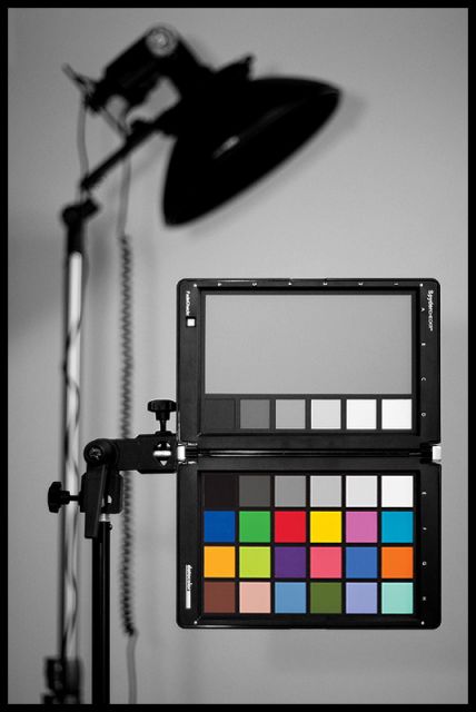

Using a device like the Passport Color Checker will ensure you're able to bring back the color YOU saw.

As John said, get a standardized color/exposure target into at least one frame under the same light as a reference: Color Checker, SpyderCheckr, WhiBal, etc., and use a color-managed workflow.
