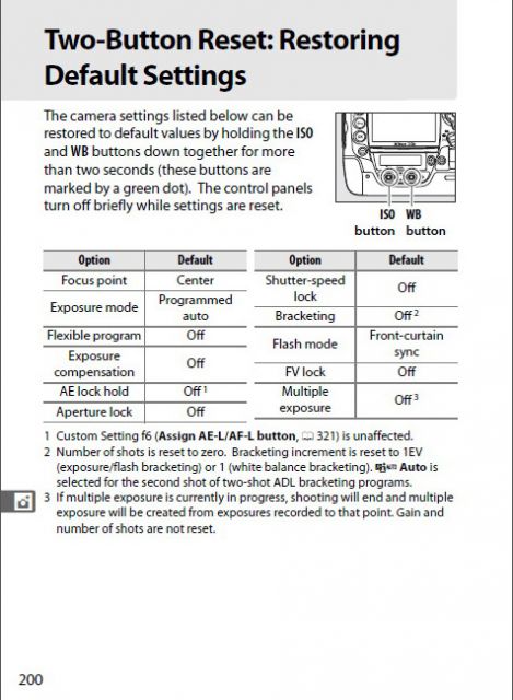

My D3s is acting as if it is in bracket mode, even though my lighting is consistent. One frame will be properly exposed, followed by two more that are over, each one "hotter" than the next, then it returns to normal. A fairly consistent problem. Very recent also.
Just wondering if I have something set wrong in a menu some where by accident.
Also, is there a way to completely reset the program that runs the camera.

what is the situation you are shooting in to get said issue
as to the reset:
pg 200 in your manual under RESET
