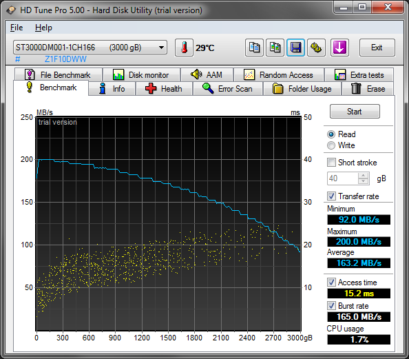

His figures are off. I've tested 3 of the new Seagate 3TB 3 platter drives and the most I can get is about 200MB/s max and about 160 MB/s average sustained read speed. Those numbers are consistent with what others are reporting. Here is the HD Tune test on one of my drives.

Putting two of them in RAID 0 will not make individual drives faster. If a single drive can sustain 200MB/s on its fastest sectors, then two drives in RAID 0 could theoretically sustain a maximum of 400MB/s acting together. In reality, this number would range from about 300 to 350 MB/s depending upon the controller and the nature of the data transfer.

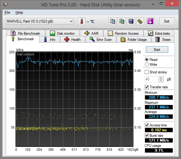

Here are some benchmarks on the same drive that have been reported by several popular sites that look just like the numbers I posted:
Here is another set of numbers for a PAIR of the Seagates running in Raid 0:
Hardwarecanucks Raid 0: Average read speed with HDTach: 311 MB/s
Very large file (10GB) read: 408 MB/s (on last page)
Very large file (10GB) write: 396 MB/s
Small file (1GB) read: 86 MB/s
Small file (1GB) write: 105 MB/s
which again is dramatically different from your claimed 440 to 500 MB/s and right in line with what everyone else is reporting (155MB/s per drive average, 200 MB/s maximum).
In your MacPro you claim you are getting 230 to 255MB/s sustained reads and writes on individual drives. Can you explain why the drives in your computer can put out sustained read and write numbers that no one else is able to replicate? Maybe the laws of Physics don't apply inside your computer, or maybe you are doing something wrong with interpreting your results, or maybe everyone else is doing something wrong. If your claims are to be believed, then one of these options has to be right. Do you agree?

Every benchmark posted in this thread, including the ones you referenced, indicates that these drives cap out at about 200 MB/s at their fastest sectors. You claimed that the drives in your computer are 15 to 28% faster than what everyone else is reporting, and you have been unable to provide any support for these numbers so far. Do you understand why people are skeptical?
