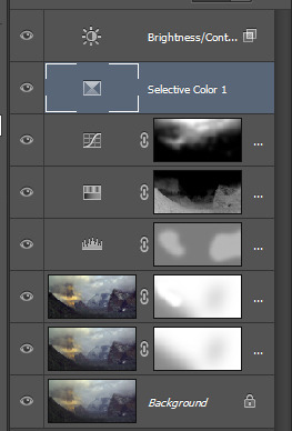

A little challenging to get smooth transitions from such small of an image, but you get the gist ... i.e. it will require selective massaging.
As always, S&P to taste.
