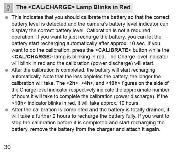

My 1D4 said to calibrate the battery during the next charge.
My 1D2 and 1D2N charger had a button to push which would discharge the battery and recharge it.
I didn't find anything in the instruction book about this for the 1D4.
When I placed the 1D4 battery in it's charger I pushed the Calibrate / Performance button and held it down
and the charger showed red for a moment but then went into the charge position.
Am I doing something wrong? Any help would be appreciated, thanks, Ken.

Here's what the manual says.

yes, that's what I found in the manual also, thanks.
The "camera" said to calibrate the battery.
I have never had the cal/charge lamp blink in red when inserting a battery.
In the 1D2 charger I could press the button anytime and have it discharge my battery and recharge it completely.
This is why I am confused.

Yes, I know this, I've tried it The batteries aren't even old. I bought to two spare batteries and the calibrate message started just a couple of months after I bought them. I checked with the retailer that were genuine and got written confirmation in the affirmative.
So if the red light flashes when the battery is inserted do you just leave it and then it will go green and start charging? Obviously if you press the button then calibration starts. I'm going to try now.
edit: Ok, I'm an idiot... if you just leave the battery sitting on the charger, the light goes green and charging begins. I am going to beat myself in the head for a bit

I'm guessing that you need to have the battery fairly discharged. When you insert the battery and the charge / condition lamp flashes, then hold down the button above it for the discharge to start.
Otherwise just charge the batteries. I think it may take 3 charges for them to become normal.
